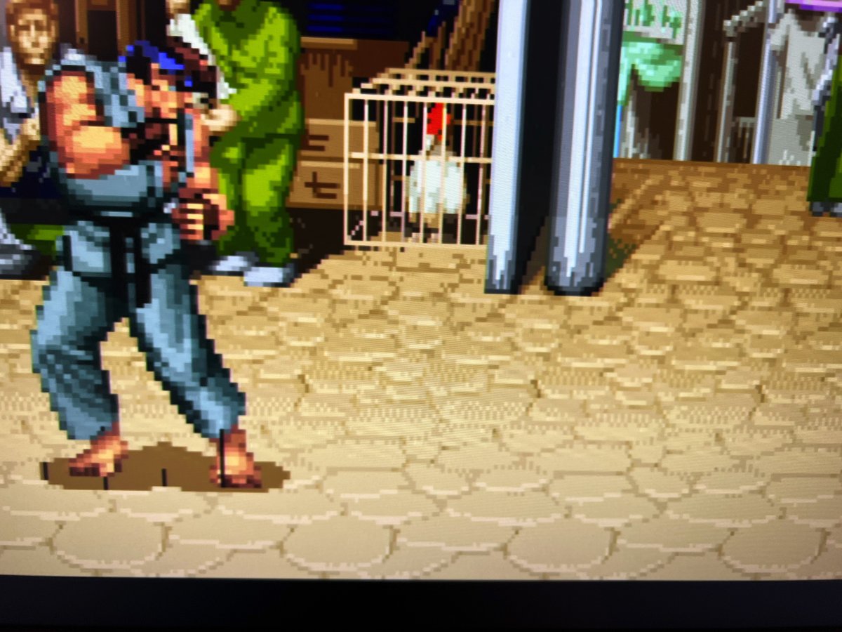

I have a CPS1 A board that has a minor graphical issue. B+C boards have been tested on two different A boards and work fine. The shadows and feet of the characters in SF2:CE, have a few vertical lines. Other than that, everything else is perfect. I did some probing on the board and compared it to the other working A boards. I havent found anything that stands out. Attached are a few pics of the artifacts. Any help or guidance would be greatly appreciated.

Thanks for the tips. Hopefully the CPS-A-01 isnt failing. These A boards are difficult to troubleshoot since a majority of the board is covered by the B board. I suspect this is a memory issue. Just a guess.

Yup. I read the chips are more reliable due to manufacturing changes. Don't know how true that is. I would think if the the A-01 chip was bad, the graphical issues would be much worse. What I am experiencing is so minor. Then again, these boards are unpredictable.

Well its not the CPS-A-01. I swapped that out tonight. Same issue. Also swapped out some of the LS245s. On a side note, I did fix another A board and C board. The C Board was tricky. It would randomly cause color issues on boot. If you reset the board a few time, it would display correctly. It was a flaky PAL - IOC1. I was able to download the .jed (Thank you Porchy and Caius) and burn it onto a GAL16V8. Things are much easier to troubleshoot when you have multiple boards to test with. Anyway, back to this issue.

This has been repaired. Bad RAM at location 2L. Replaced the RAM chip and the graphical glitches are gone. Lots of troubleshooting with this one. When troubleshooting these boards, especially ram issues, I highly recommend getting female pin headers and socketing the ZIP ram. I cut the strips into rows of 14 pins, straightened the legs on the ZIP chips and inserted them. It made RAM testing much easier. I could easily swap in a known good chip and move on.
