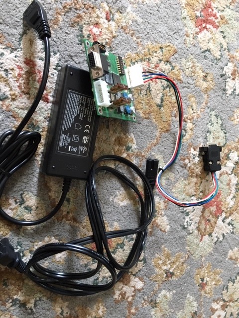

I had a couple questions about hooking it up. The items did not come with any connectors

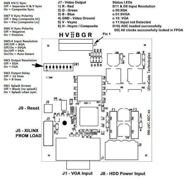

The manual says to hook up the J7 Strip to video output. Do you know what this connector is?

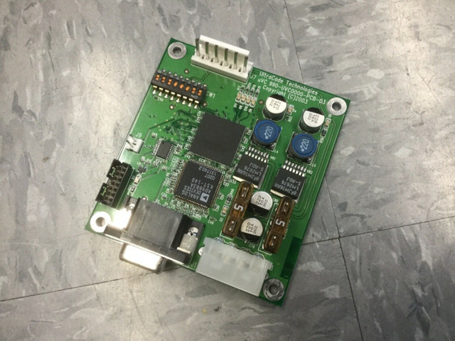

It has the the 6 pins sticking out in the picture in the top of the board

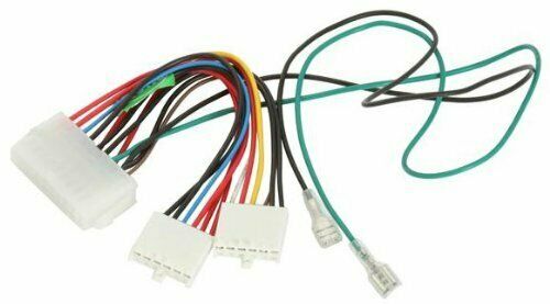

Emphatics website shows a setup on a Jamma finger board. Do anyone know the proper 4 pin Molex connector with leads that can be used on this UVC?
The manual lists it as "PC Hard Drive power connector" but Emphatics picture looks like he jumped a yellow wire into the connector.

@Lemony Vengeance made me a connector that work and power as well, VGA style..
I believe those are standard arcade monitor chassis connectors, 6-pin Molex in-line (IL) .156. They're not very difficult to find. Most online arcade parts shops have them, or you can grab them from digikey or somewhere similar.
