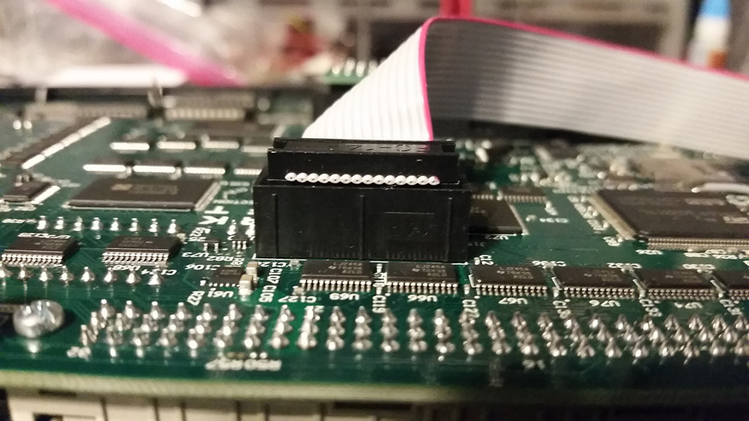

Here you can see everything is fully seated:

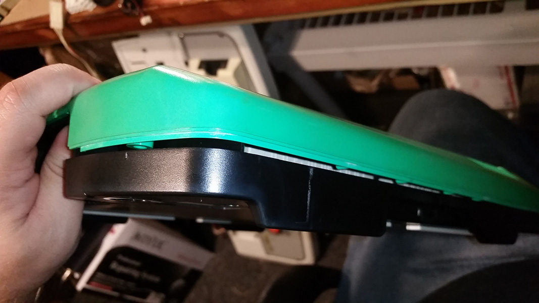

When I clip in the front of the lid the back of the lid has a gap like this:

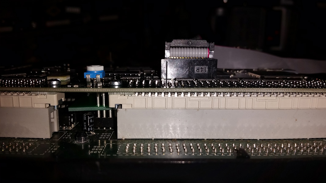

Peaking inside I can see the ribbon cable connector hitting the lid
Is this normal? is there some kind of modification I'm supposed to be doing to the ribbon cable to make it fit? did I get an extra tall one? or is there something else going on here?

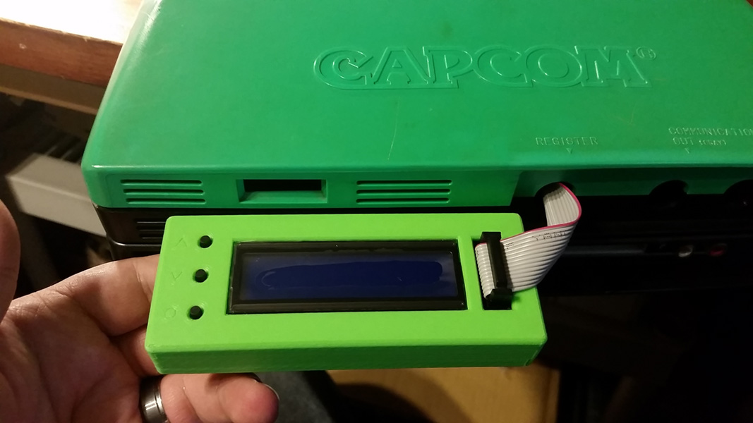

I'm also curious how long your cable is because mine is crazy short. like if I pull out all the slack and route it out the "register" port I only have about 2in of cable left which is just barely enough to turn the LCD sideways to read it, and even then it's pulled taught just to do that, which probably isn't very good for it's lifespan.
that's all she's got!
