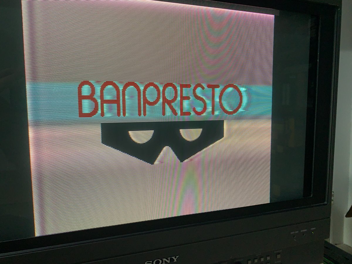

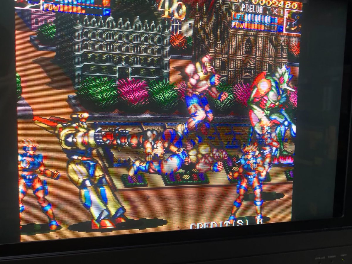

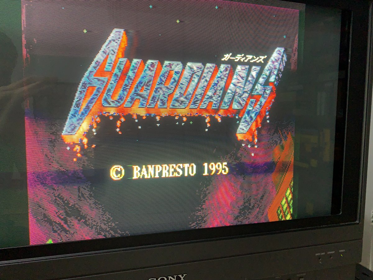

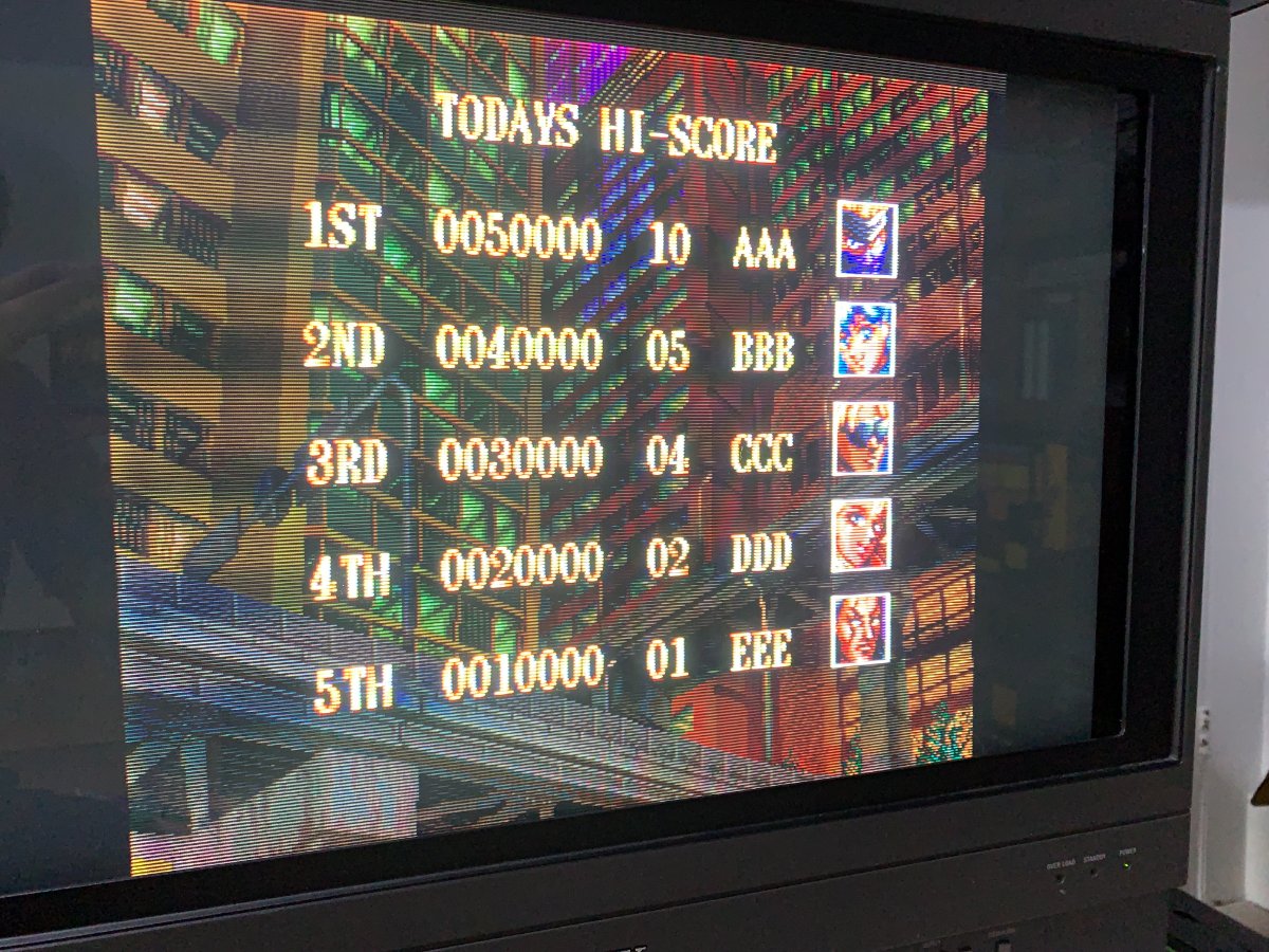

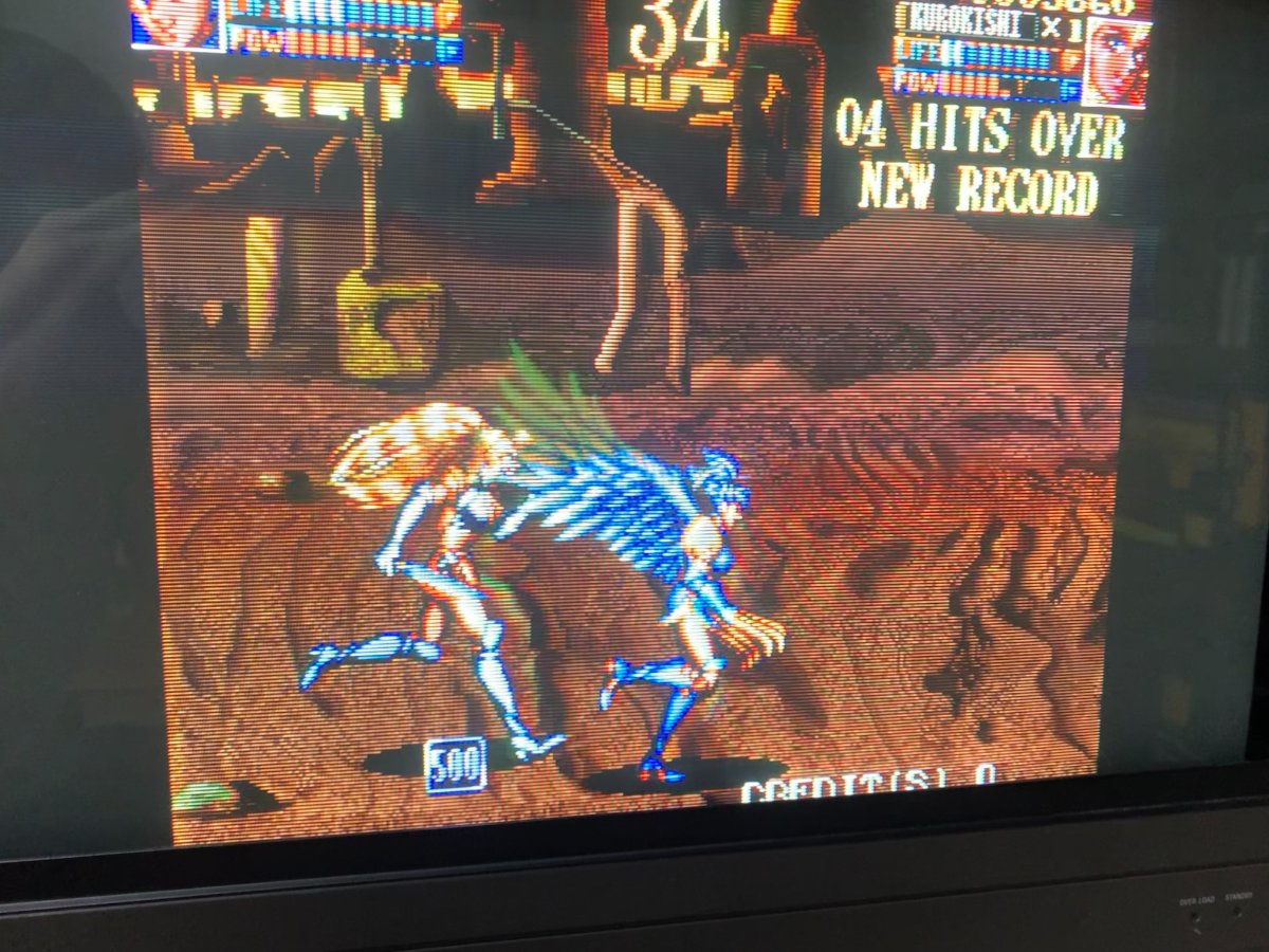

I’m seeing an issue with horizontal smearing and ghosting on my BVM D24 that only occurs when running certain PCBs. I've attached some pictures of the issue in Guardians. I haven't been able to figure out any obvious pattern among PCBs that have this issue but here's a few that I've checked:
Bad: Guardians, Cannon-Dancer, Metamorphic Force
Good: Toaplan Version 2, Mystic Warriors, Moo Mesa, Edward Randy, The Outfoxies
I also verified that this is happening with both my Axunworks and Sigma AV7000 superguns.
Any insights into what could be causing this?
