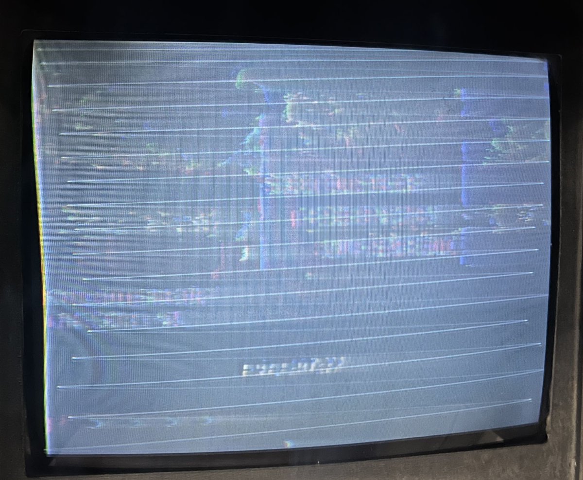

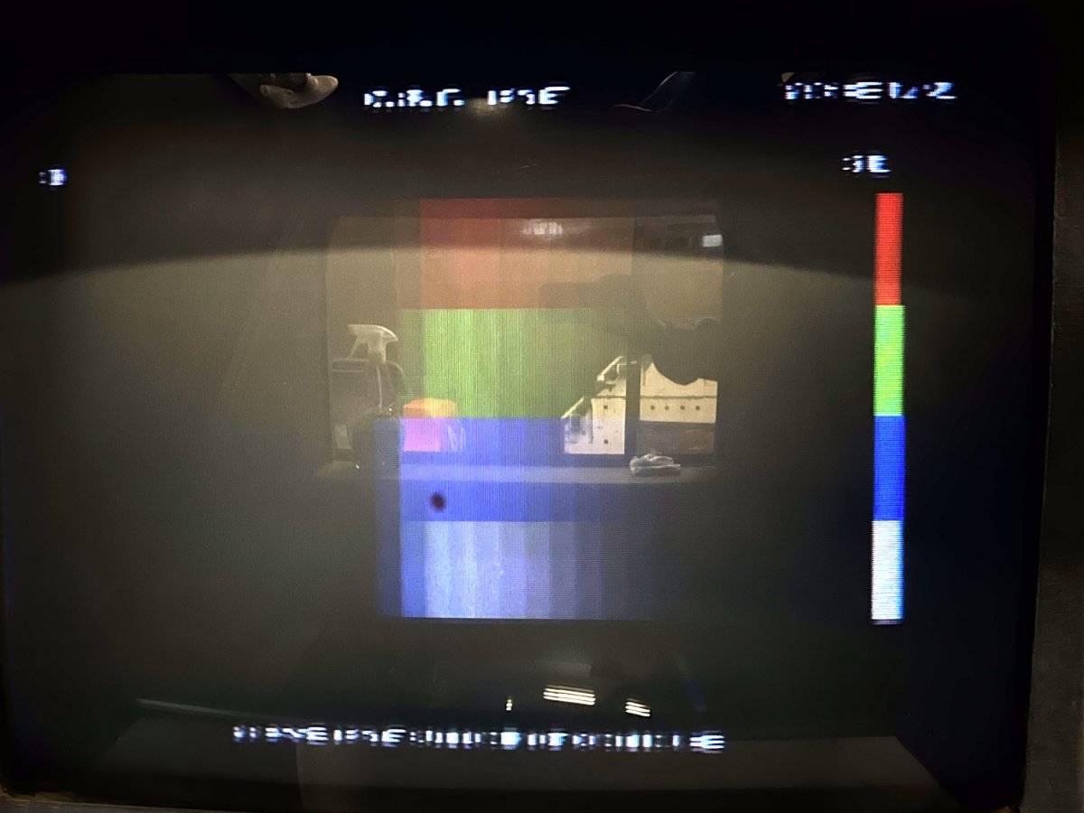

  • Next power on, colors suck. Nothing broke anymore, but colors are kind of shadows only, like only the bleed can be seen, not colors themselves, fiddled with pots (gain, cutoff, brightness and screen) in all possible ways, no improvement. It looks like only the mid-brightness part of a color can be seen, and it's full brightness becomes invisible, kind of an inverted brightness feel, difficult to explain.

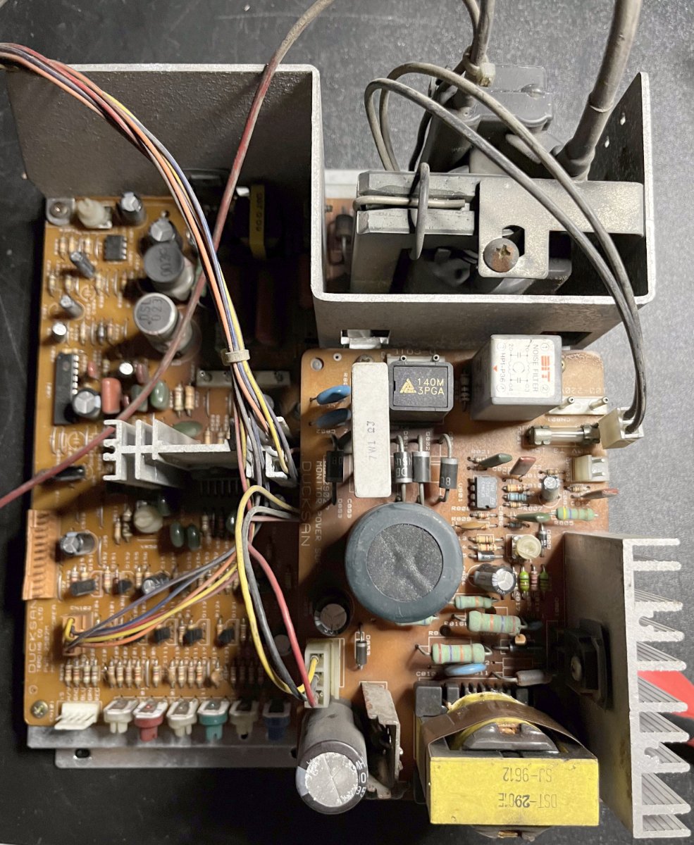

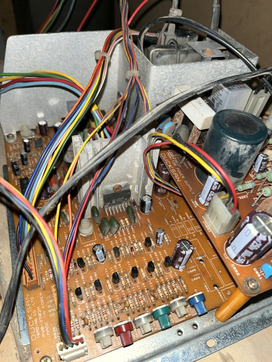

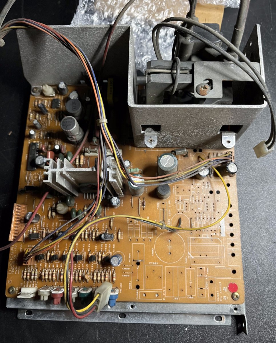

Seems I don't have a picture from the neck board, will attach soon, it doesn't have any IC, just transistors. The first is from when it worked, then the current issue, then the chassis with and without its PSU module.
