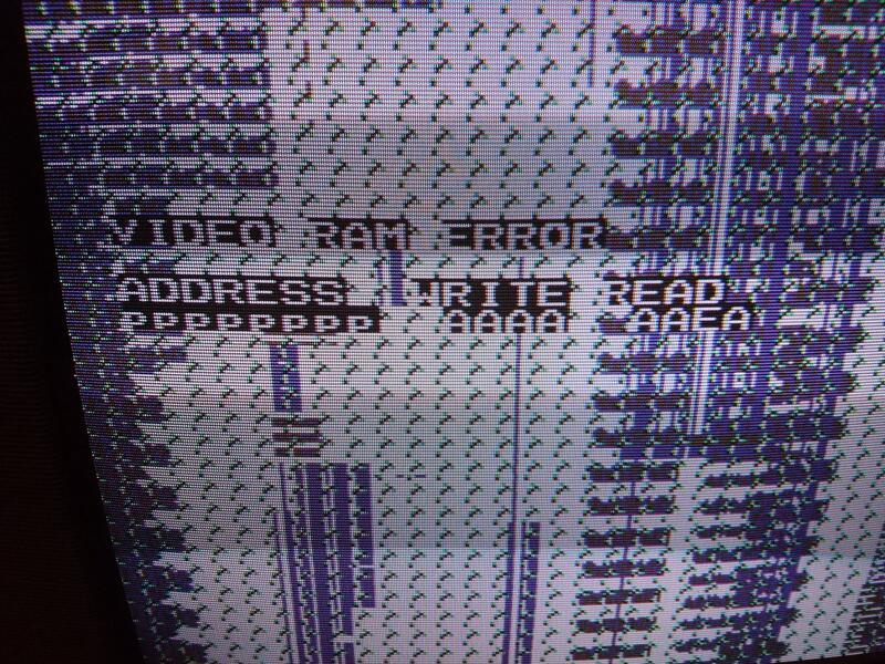

Unfortunately, with a card inserted, now it's stuck with another error:
Code:
VIDEO RAM ERROR
ADDRESS  WRITE READ
pppppppp  AAAA  AAEA
The board is an MV1B, according to the NEO GEO dev WiKi the video RAM should be the two Toshiba TC55257FDL-85L chips named RAM5 and RAM6. The tracks don't appear broken, tomorrow I'm going to inspect them with more attention, but I suppose I need to find a couple of new RAM modules.
Suggestions?

curious, if you leave it on that screen for a little (30 seconds or so) does the garbage in the background change/shimmer?
Yes, IIRC there are few pixels that change in a vertical pattern, it's not a static screen.
Having the screen non-static like that is usually an indication of a floating signal. This is further backed up by your symptoms where it boots to crosshatch without a cart, but gives the error with a cart. Its likely the cart's weight is enough to tweak the board to break a loose connection. I would use a fine tipped set of tweezers to apply a light side pressure to the pins of ram5/6 and NEO-GRC2 V5D*, V6D* and VA* pins to see if any of them are loose. Based on your screenshot its very likely related to RAM5 pin 18 (d6) <=> NEO-GRC2 pin 158 (V5D6)

Also, for that error you got, check pins 20, 22, and 27 for proper operation on both chips. One may be missing a signal. That could cause t he error message you're seeing.
@ack, dude! Amazing!
As you predicted, pin 159 in the NEO-GRC2 was loose, color me impressed.

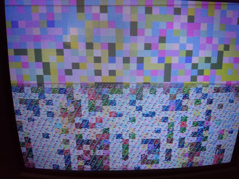

I had great expectations, but now unfortunately, when powering it on, it always shows pulsating random colored blocks, even without a cart... (╥﹏╥)
To be honest, the other day I didn't checked for shorts on the replaced NEO-BUF and guess what, B0 B1 and B2 appear to be shorted, it's the side near the dip switches. I'm wondering how the other day it could reach the cross hatch screen but not now? (wild guess I would say the video RAM's check is at the beginning of the boot sequence)
Anyway, back to fix the NEO-BUF...
If that pin was loose there could be others, which maybe causing the watchdog. I would check them all (on all the surface mount chips). You could also power on the board while applying downward pressure on one of the surface mount chips (trying this on each of them) to see if get a behavior change/crosshatch. This can sometimes direct you to the chip or area of a board that has a loose connection.

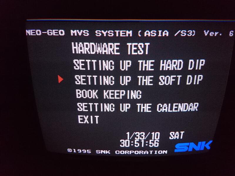

Good news everyone, a colleague revised some of the soldering on the NEO-BUF repro — the castellated holes were not easy to solder — and now the board boots!
٩(^ᗜ^ )و ´-
Big thanks to @ack, @channelmaniac, @ShootTheCore and @Neo-Alec for all the tips, without you guys I wouldn't have been able to pull it off.
