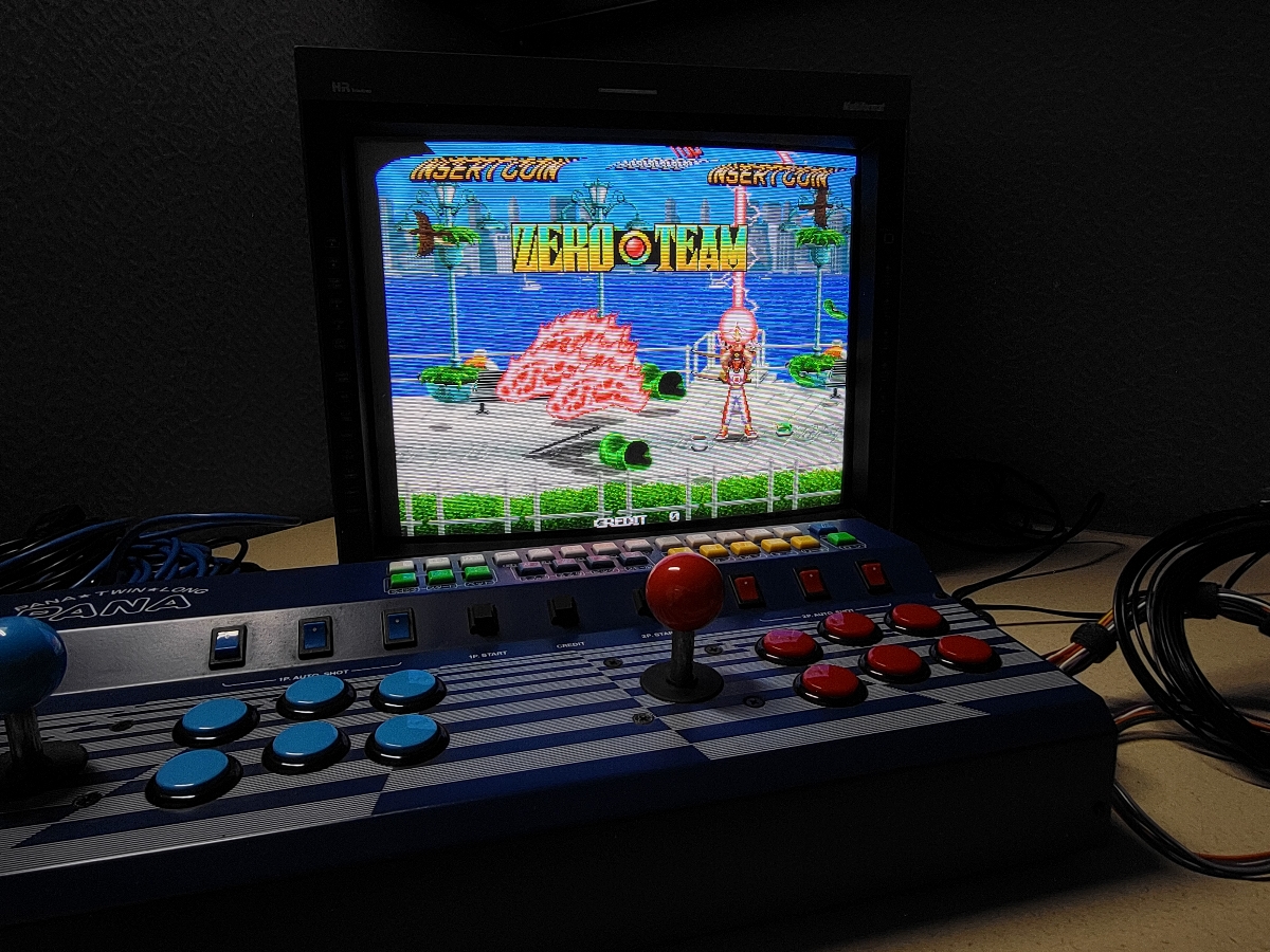

Not sure if this is the right section to ask about this, but I have a Pana Twin Long supergun/control box that I am pairing with various PCB's and getting "bending" at the top. Some search results have led me to devices such as the Extron 203 RXI. Will this help eliminate this issue? Is there some better solution out there?

Zero Team (and other Seibu stuff) specifically is weird on my PVM too. What other games have you tested it with?
Actually, disregard my last post, it works fine on my 20M2U. Not sure why I remember having similar problems with it.
