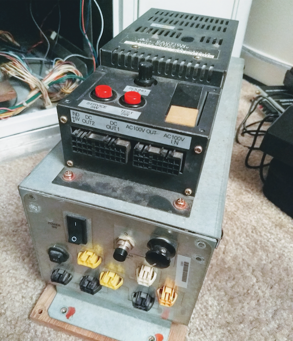

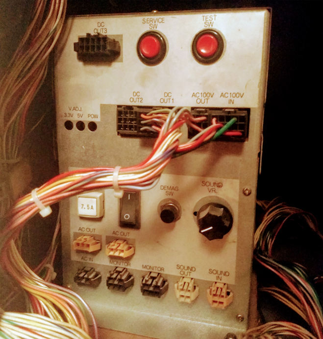

I'm the new owner of two Astro Cities (not NACs), and after a few weeks of cleaning them up I'm eager to turn them on finally.
However, I haven't been able to find many guides online outside on hooking up the PSUs properly, other than users reporting issues with theirs.
Do I have everything hooked up properly? What am I missing?
I have three power supplies:
• 400-5198 in cab #1
• NVS-4000 in cab #2
• 400-5261-01X (unused)
I'm going to be running CPS2 and MVS games.
Cab 1 already had everything plugged in, though I haven't turned it on.
Cab 2 didn't have anything plugged into the PSU, so I plugged in the AC100V out/in, the DC out etc. but I'm not sure if I'm missing anything else.
I have replaced the speakers in both cabs with Logitech Z5500s, which are running on their own separate amp (the Lepai 2020TI).
So I am assuming I may need a separate harness or something to power the 2020TI into the PSU, if that's even possible.
I'm totally new to all this stuff, but I'm really eager to learn, so any comments are helpful, thanks.
