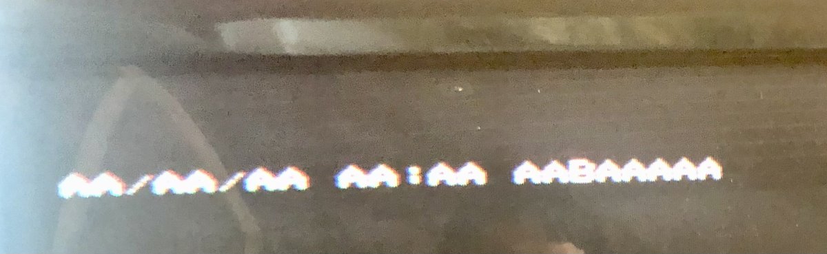

When I the game boot up both carts they show following message on screen;
“HYPER NEOGEO64 System Log Reader SetUp Wait a moment”
After 10 seconds the message change to follows;
“AA/AA/AA AA:AA AABAAAAA”
It stay on this screen forever!
IMO Fatal Fury Wild Ambition is a common game on Hyper NG64. Anyone have an idea to solve this please kindly help!
