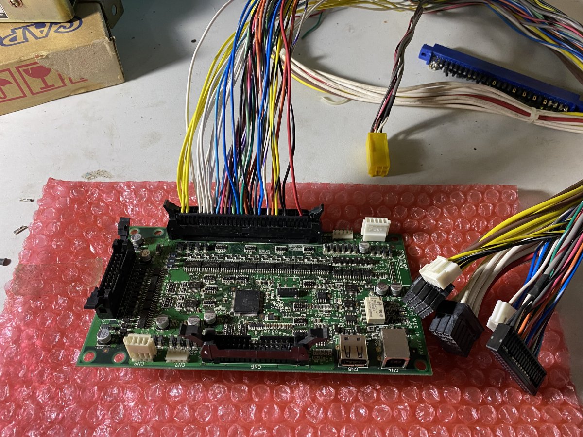

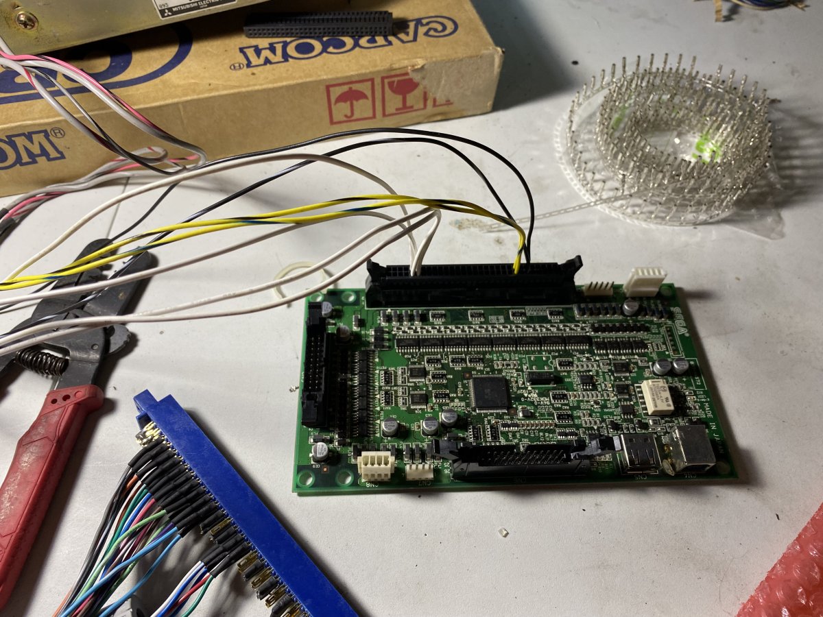

...so I started to "mutilate" a Blast City JAMMA harness to be used with a sega type 3 JVS I/O. In my case, to use this I/O with a naomi rather than the Capcom JVS to JAMMA adapter.
I still have 1 more Blast harness, so I can have both options.
I've re-purposed 2 of the video signal cables as Input P1 and P2 6th input and the video ground cable as an extra ground to be used with the Blast City CN8 conector.
