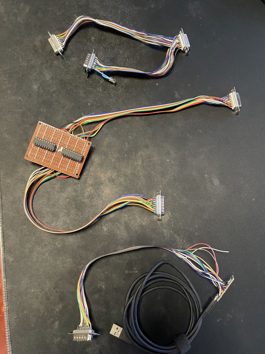

I've done this already using a Daemonbite USB encoder for the PC side and 74LS245s on the JAMMA side so that the PCB doesn't cause issues with reading inputs on the USB side.
I attached a picture showing my setup. Top is the DB15 (Neo geo) splitter (with LED for lag testing), middle is the 74LS245x2 board for the JAMMA side, and bottom is the Daemonbite USB encoder.
Then you can use something like https://obsproject.com/forum/resources/display-fightstick-motions.344/
to generate the joystick overlay. You can check some of my recent Gradius IV streams to see how it looks:
https://www.youtube.com/channel/UC3jJN_NS6XKnzYKt_dcVJew
You could also do something similar with a RasPi, as this guy's project:
https://github.com/wnka/arcadebuttons-node-pi
This would probably be more suitable for a cabinet since you could transmit the buttons wirelessly using Wi-Fi.
