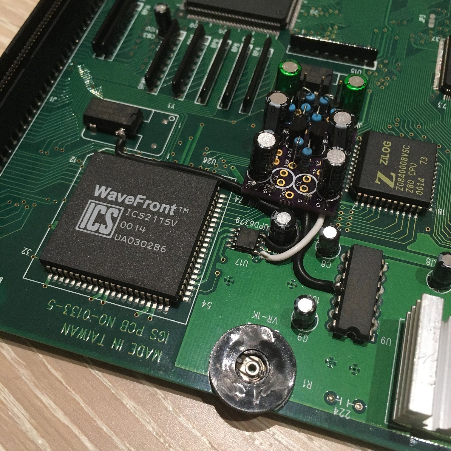

I can happily run my PGM on 5v only. Used a 5v mod on the audio section:
My board is the one above right.
