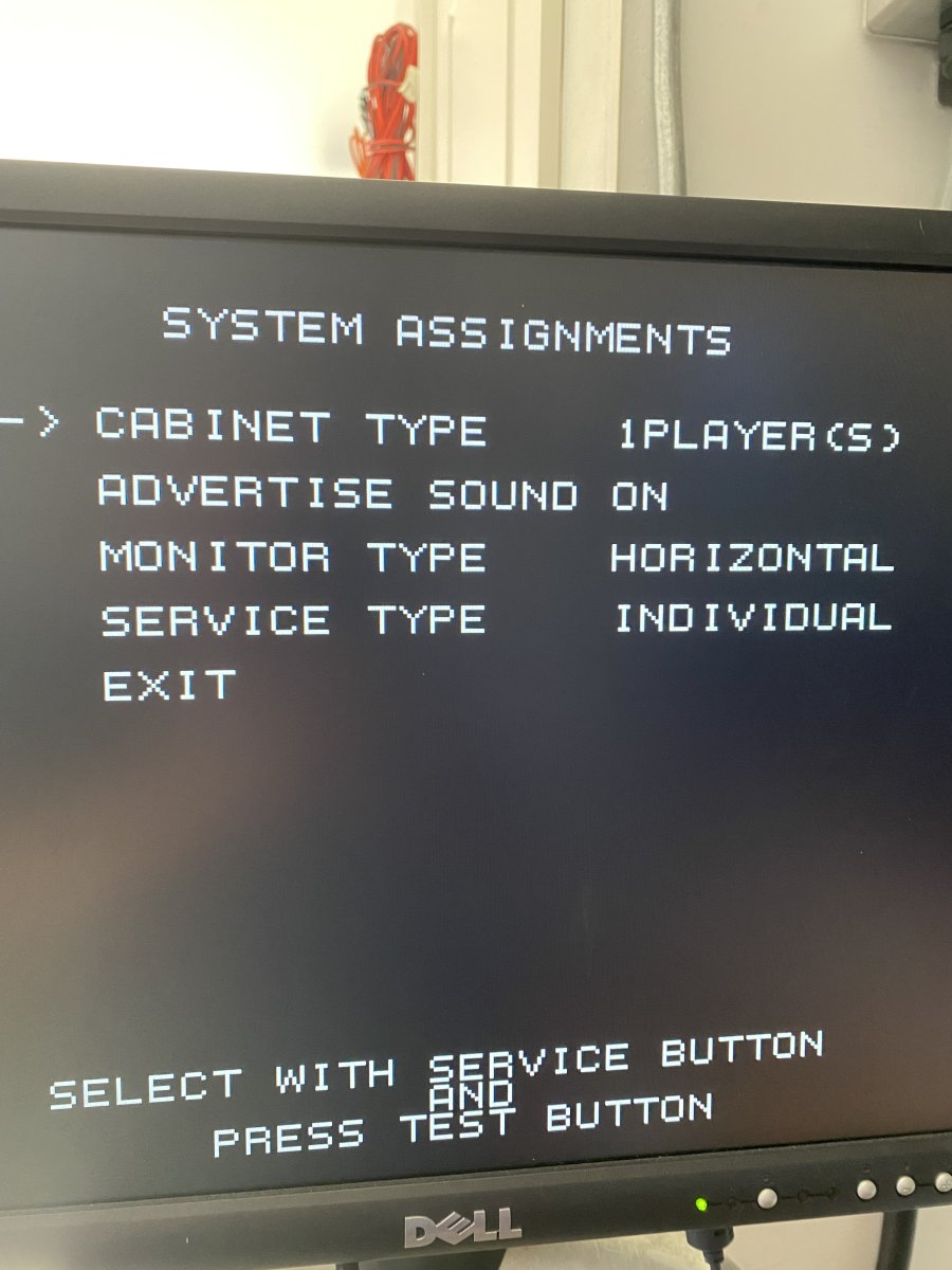

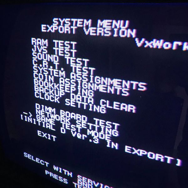

Quite Strange - I can't find the screen referenced on page 47. Here are the two screens that I see - System Assignments in the Naomi2 menu, and Game Settings in the InitialD3 test mode submenu.

System Menu...Network Setting...Network Type (What are the options...should not be ether).
The game should be loaded into memory, so adjusting the network should not effect it loading after menu changes.
I had mine running off the gd-roms, and always wondered about the "ether" setting
So - there are 3 settings.
Ether (used for netbooting - uses the ethernet port on the netdimm)
Mobile (you can set an ip address, but no netmask, gateway, etc.)
None
(there is also a ether+mobile, defaulting either to ether or mobile).
I tried the mobile - and set the ip address to 10.0.0.2 on one, and 10.0.0.3 on the other - it exhibited the same behaviour.
