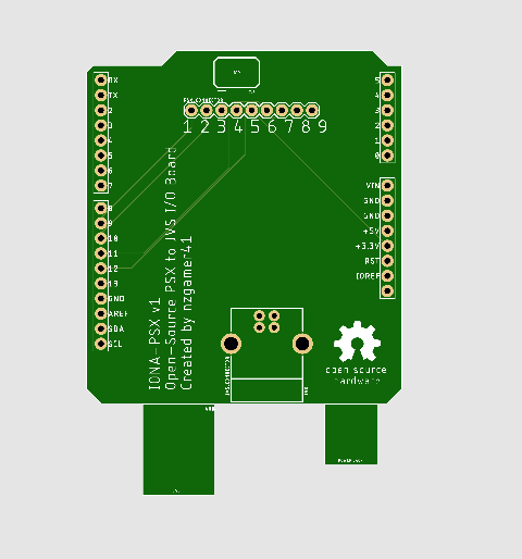

I intend for this to be fully Open Source, so anyone can modify the code as well as produce the custom Arduino shield I have designed. I have got some prototype PCBs coming from JLCPCB which I should hopefully have within a week or two allowing for delays due to COVID-19. Down the line I may look into seeing if I can sell pre-assembled boards, or designing an all-in-one board that integrates the Arduino and maybe an LCD into one single board, but for now I feel this is the best solution, since it means that anyone can use it with a regular Arduino Uno and a prototyping shield if they really want.

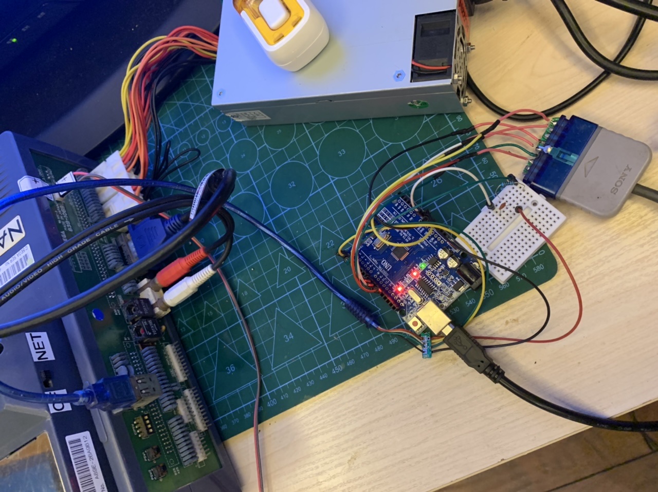

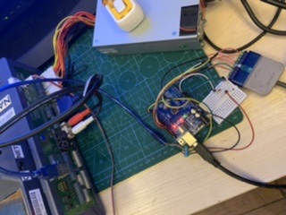

I've included a mockup of the PCB from the manufacturer, as well as a picture of the prototyping board I've been using to test the software side.

Hello everyone, completely forgot to post up the stuff I had mentioned re board schematics.
https://github.com/nzgamer41/IONA-PSX-PCB/ is where for the foreseeable future I will keep board schematic files.
The bill of materials will be coming shortly, honestly just need to figure out how to write one.
I used Autodesk EAGLE to create the schematics, if there's a way to import the files into other PCB design software feel free to try but for simplicity I'd recommend using EAGLE since that's what I did it in. You'll need the SparkFun libraries as well as the Open Source Hardware library for the logo (google is your friend).
EDIT: To be clear, this is the v1 board that is single player and has a pin header for the psx port, not a spot to solder in a female connector. The new v2 board is coming, just need to make some adjustments to it and get a prototype made.

Hello,I found the psx pin definition on the schematic (D9 D10 D11 D12)is different from the one in the code :Psx.setupPins(8, 9, 11, 12, 10).
I upload this project to my uno and connected all the pins and components,but still doesn't work on my naomi 2. ?(
Hey, good to hear you got the iona-346 project working with your saturn pad, i think the git repo for my iona-psx code is missing some working code which is on my dev machine (I have been using a separate computer for all the Arduino programming), I will double check against that this week and push new code, there is the possibility it might not work on naomi yet (I don't see why not but I've only got a TTX so have only tested it on that), could be as simple as changing the JVS identifier to pretend it's a SEGA JVS board.
EDIT: Also the pinout's a bit weird on git because on my prototyping board (before i got PCBs manufactured) i accidentally shorted pins 9 and 10 together (don't do this) so rather then desoldering the bridge i just moved the pin down one. new code fixes this
