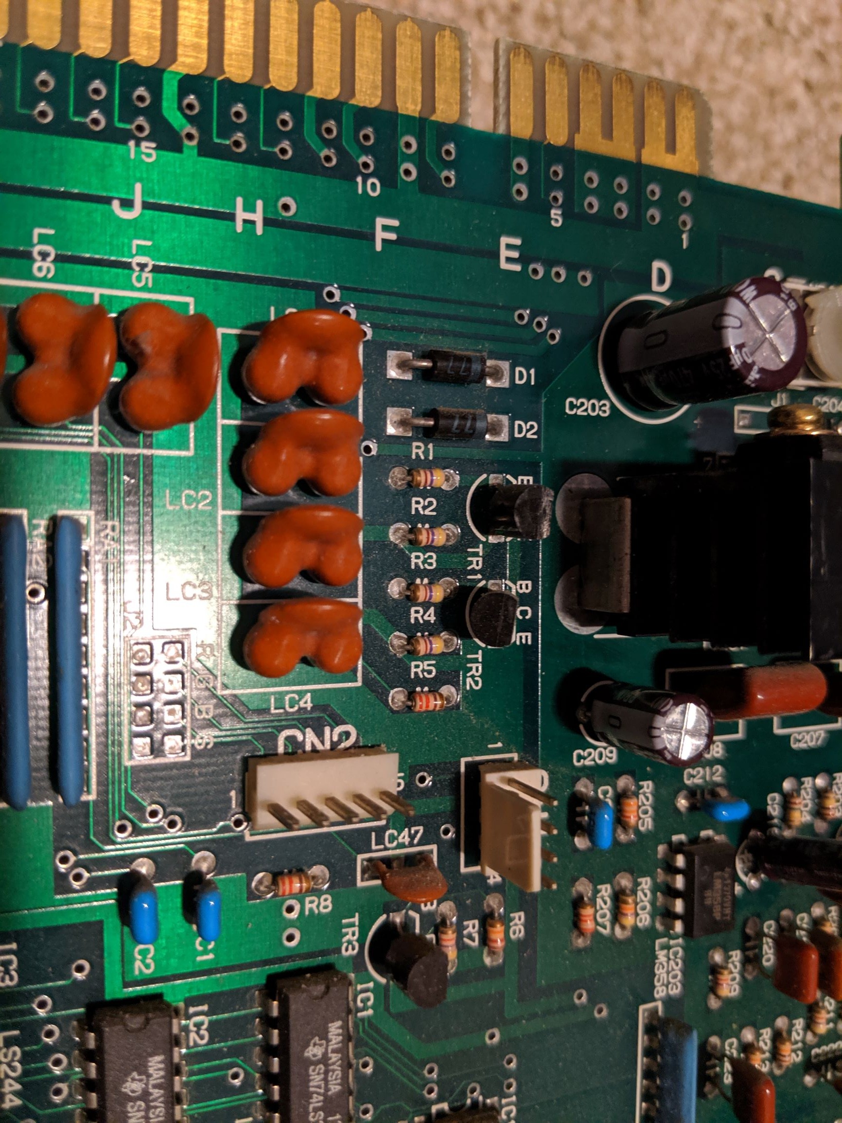

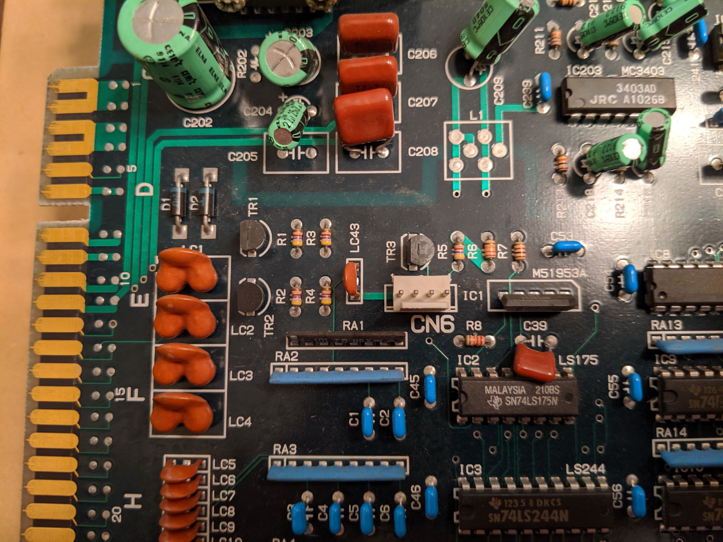

Attached are closeups of my Major Title 2 and Bomberman PCBs.
They appear to have 4x 470 ohm resistors, R1 through R4. Are these the resistors that go to R,G,B and sync? Maybe try lowering these values down to 220 ohm? What do you think?

IIRC those are just one component of the DAC. I changed those out, and found that only one bit in the signal changed, which isn't suitable.
A cheapo hack could be to duplicate the DAC resistors in parallel with the current ones, to halve all of them :P
So the resistor arrays probably needed to be changed. Not sure how easy it would be to find a suitable replacement SIP. Maybe just do it the quick and dirty way where you stick a bunch of resistors up and tie them together.
Probably not a great solution for collectors that have several Irem boards. I'm starting to think that a JAMMA passthrough with a small RGB amp may be a better solution after all.
Finding a SIP package for resistors shouldn't be too hard, they are very common items. But seriously, you can buy the exact same one, wire it invisibly in parallel on the underside, and the video level should double, without having to remove the original.

Isn't that some kind of R-2R network? Somewhere I read a repair log where someone replaced it with a small custom PCB.
You do get them off-the-shelf, but I just looked and you don't get a particularly large range of values.
