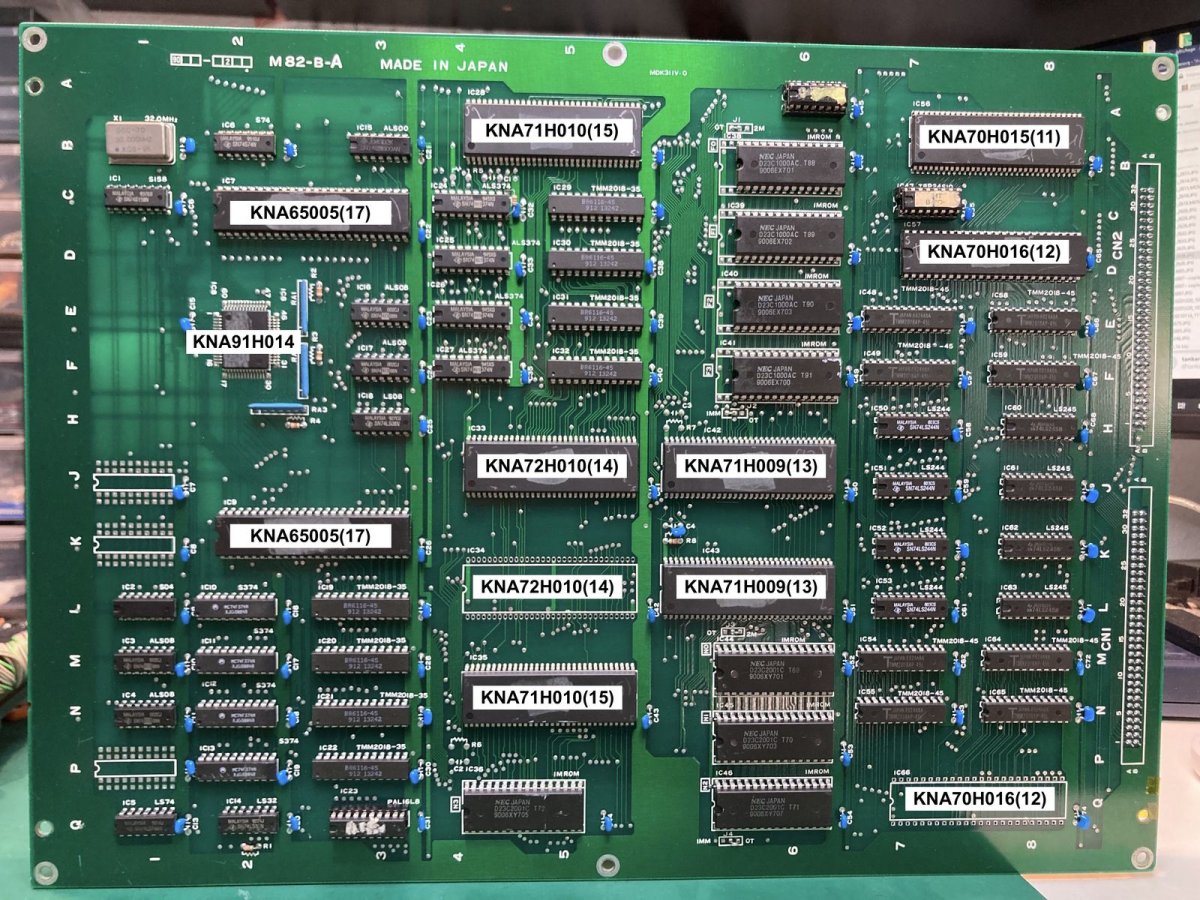

Hi all,
Some years ago Seb from Rep'Arcade mapped the Nanao custom chips for the Irem M82 hardware:
https://www.rep-arcade.com/2021/05/saigo-no-nindou-irem-m72.html

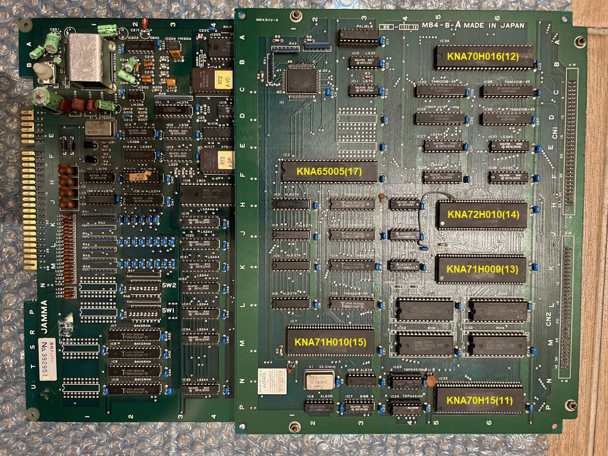

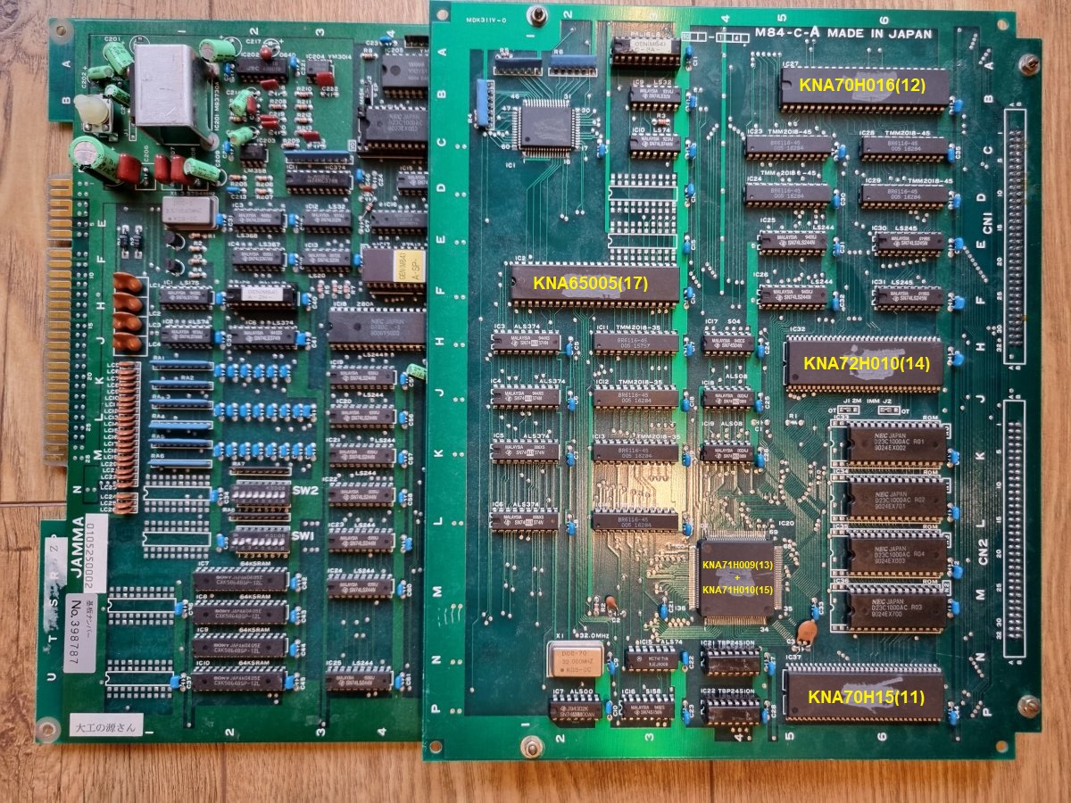

Now I did the same for the two different romboard types used on M84:
Hope this will be useful to others in their repairs.
