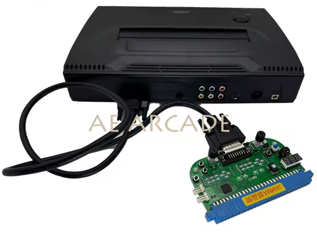

I've been using a consolized MVS from Aliexpress that has an extension cable that connects to a jamma connector, allowing for other boards to be played. It uses a 12V psu and adjusts voltage accordingly.
