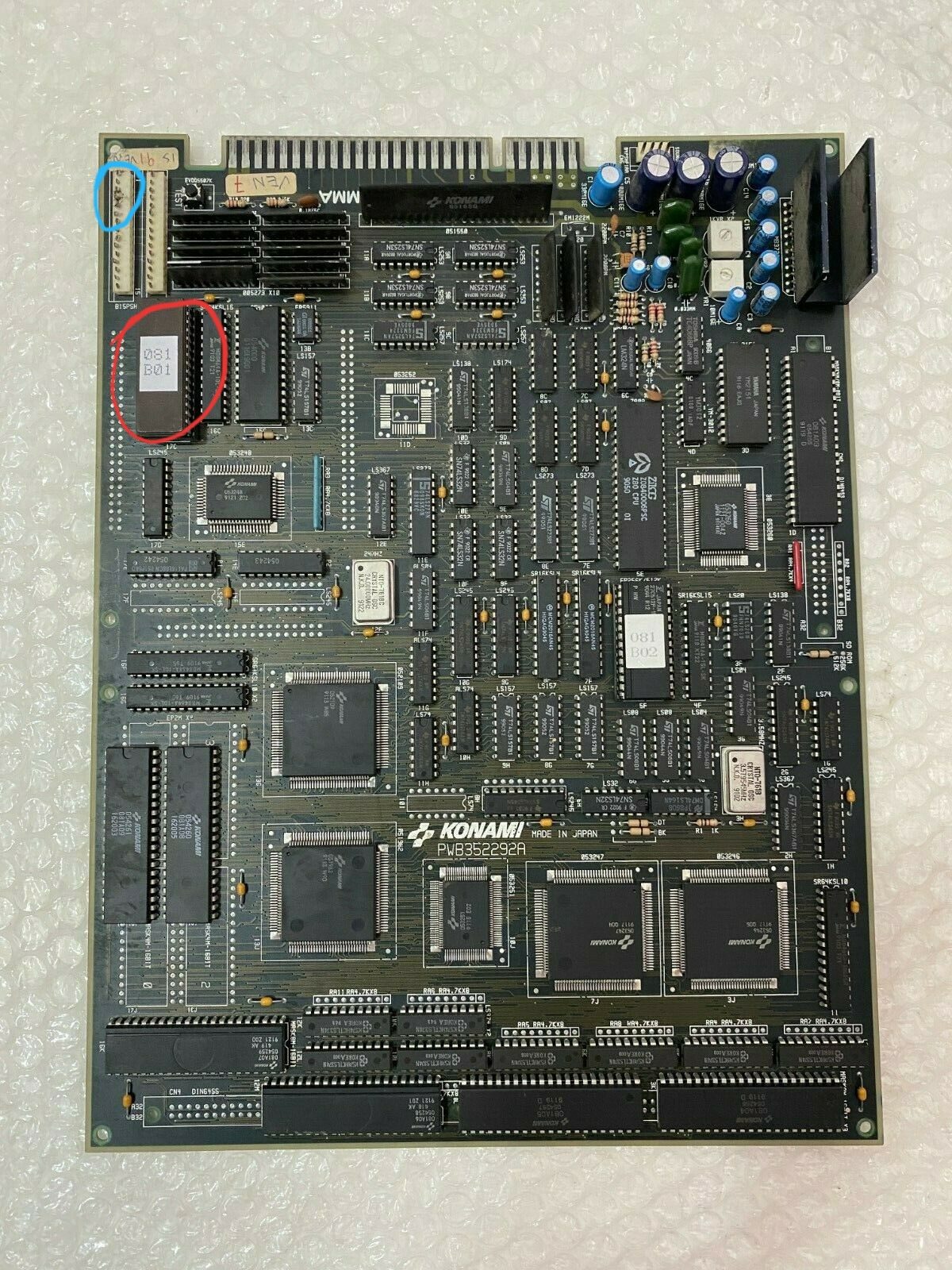

Hi guys ,i want to know please if this crime fighters/vendetta jap version pcb is original with no conversion or repair on eproms, and if all stickers/eprom on it are original.

The eprom/sticker on the red circle looks like it was changed or not original, or i am wrong ?
The pins on the blue circle are like if ot was repaired no ?
Also in your opinion what is the condition of this board according to you ?

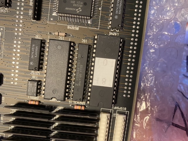

It is an original board, but it looks like there was some work done on it. The label on that eprom is definitely not original. They might had to have replaced a faulty eprom before.

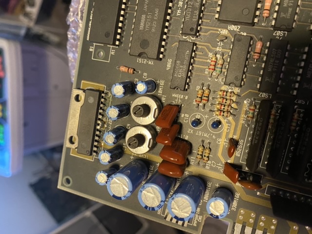

Also the pots in the audio section are not original too. They’re supposed to be the can looking pots like this:
So there definitely some repairs done.

So it looks like an original PCB, however probably not originally Japanese. Some people prefer the uncensored Japanese version. Some people think Japanese PCBs are more valuable.
That is all for you to decide, but I would say I would not pay "Japanese PCB" prices for a board that does not have original Japanese EPROM stickers.

I'd say the pots are original. The same Konami board sometimes use one type or another.
How to be sure ?

look at the soldering on the pots,
you will know if they have been changed.

Notice that far right EPROM sticker? It looks very new and clean compared to the other two...
Also, it doesn't look factory cut.
Finally, the sound chip has not been recapped (it seems from this one picture), so make sure you take care of that ASAP if you buy this board, it is probably already leaking!

one sticker has been lifted and re-applied, the other is a copy.
also the eprom has taken a beating!
