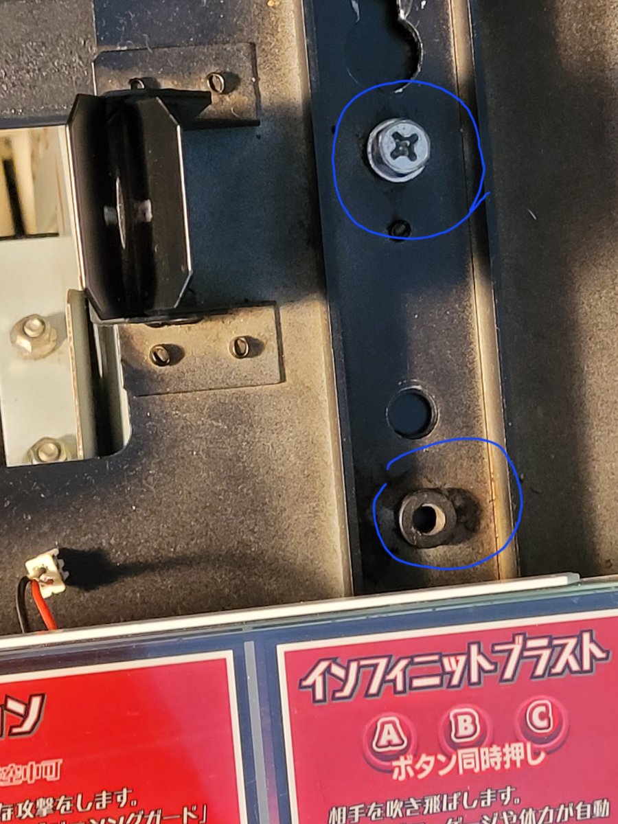

H hyunatl Student Joined Dec 23, 2023 Messages 25 Reaction score 8 Location Chicago suburbs Jun 14, 2025 #1 There are different holes. Not sure which is the right ones. Are the ones circled in blue the place I am supposed to bolt in the control panel? Thanks Attachments 20250614_152039.jpg 194.8 KB · Views: 51
nem Immortal Joined May 29, 2016 Messages 7,728 Reaction score 8,451 Location Finland Jun 15, 2025 #2 No, it's the holes above the blue circles. One is enlarged so you can slide the control panel in place. The ones inside the circles are for the vertical shipping brackets.
H hyunatl Student Joined Dec 23, 2023 Messages 25 Reaction score 8 Location Chicago suburbs Jun 16, 2025 #3 nem said: No, it's the holes above the blue circles. One is enlarged so you can slide the control panel in place. The ones inside the circles are for the vertical shipping brackets. Click to expand... Thanks
