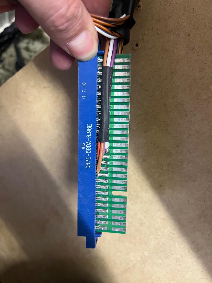

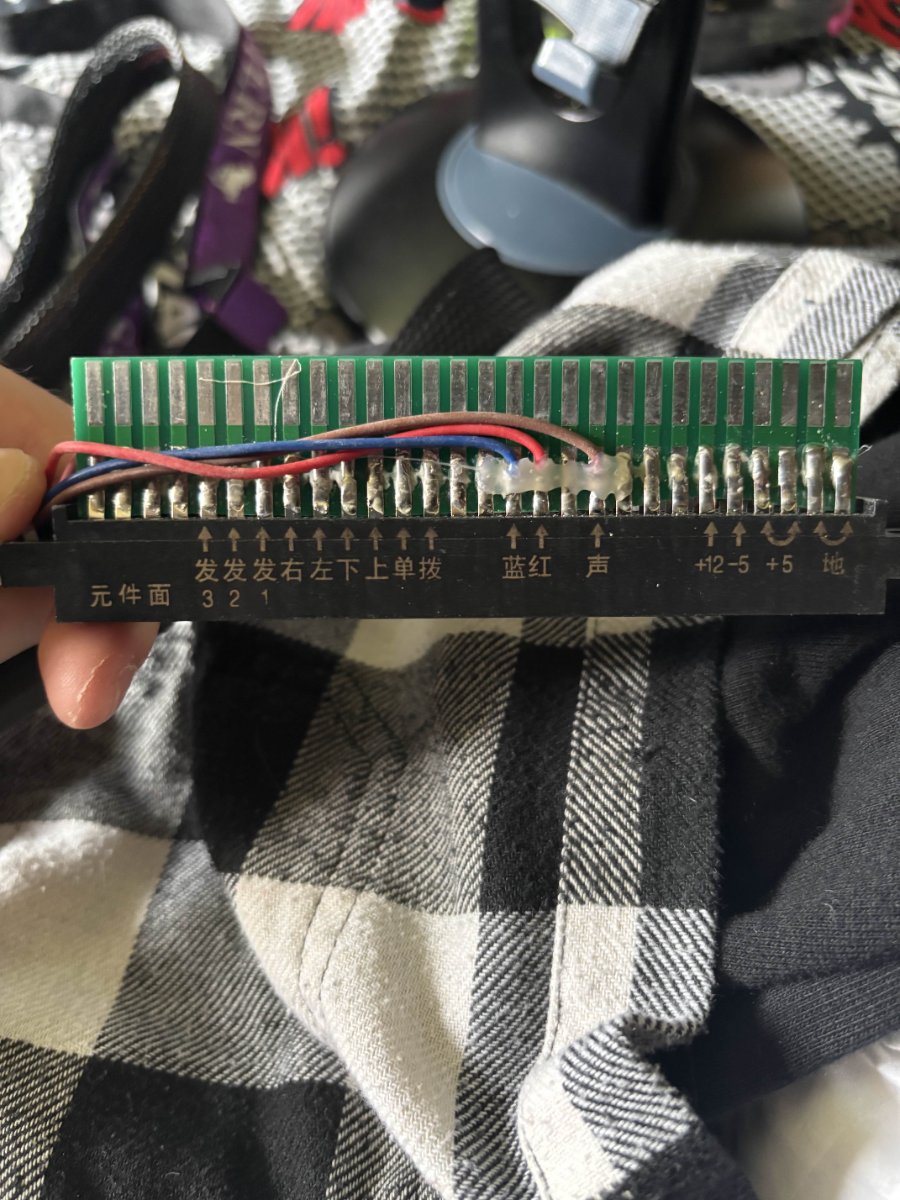

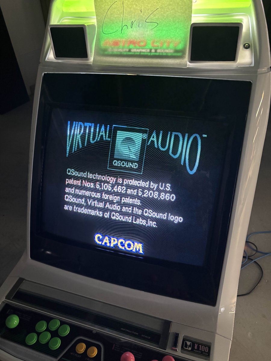

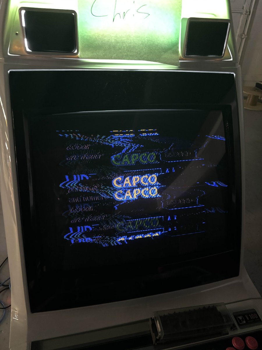

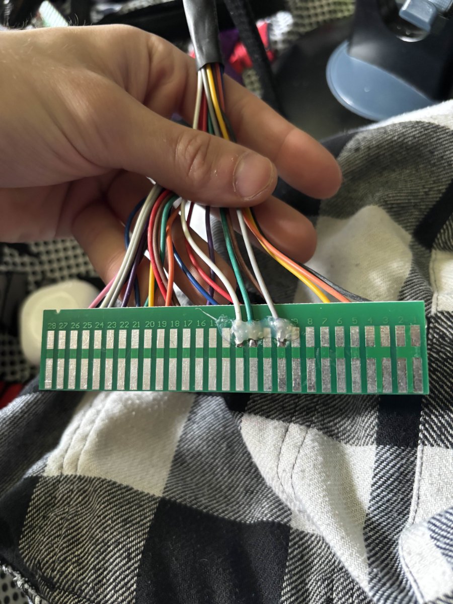

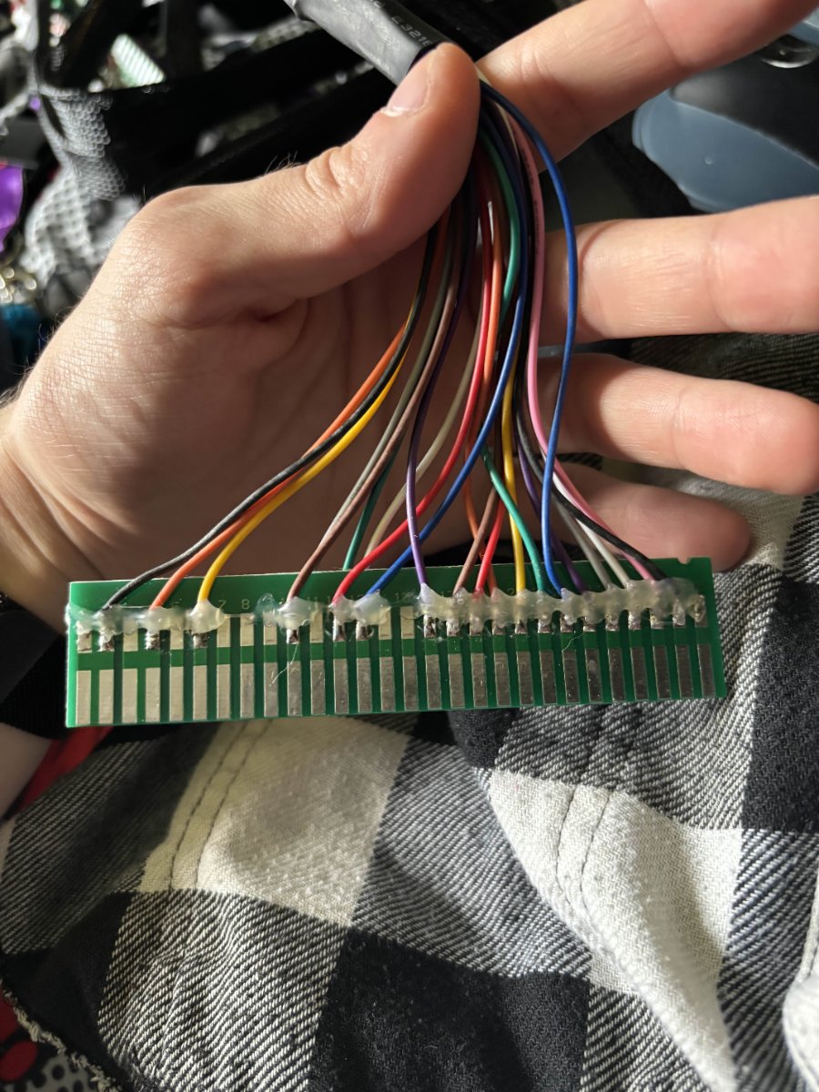

I recently purchased these link cables to connect 2 NAS cabinets together for head to head gameplay however it seems on the slave unit the monitor output is completely messed up. Sometimes its dim and it always has some sort of sync issues
MASTER VS. SLAVE
Here is what the harness looks like:
Any help or advice is appreciated.
That cable really doesn't look fit for purpose... The bare PCB on the side without the socket is also a bit risky since it's easy to install upside down and accidentally push 5V where it doesn't belong for some magic smoke action. With the boogery hot glue everywhere, I would be checking for the quality of the solder joints, assuming this cable is supposed to work at all. Usually I would see major dimming/sync issues when only one of the two linked cabs are powered on. Another thing you should check is that if the cable is actually JAMMA or CHAMMA, since there's no kick harness. There may be some differences in wiring that ends up messing with video as well.

Based on the photos shown, there's a wire (pink) soldered to pin#26, which means that this is probably wired for CHAMMA. Unless your cab harnesses are also CHAMMA, this would be the first thing to correct.

Agree with others in the thread, this looks like it is wired for CHAMMA, and that fingerboard missing the JAMMA key is a bad day waiting to happen. My advice: buy another harness.
If you are like "sunk cost!", or you're just open to trying to fix it or picking up a project, I'd pull up CHAMMA and JAMMA diagrams, buy a new fingerboard with the correct JAMMA key, then re-wire. You might also want to get a CPS-2 connector/pig tail and wire that in while you're at it, it'll make things a lot easier.

Yes, both sides should be powering the harness. Otherwise you're splitting video between two cabs with one power source. If you ever used a crappy passive VGA splitter before, I imagine the effect would be similar. There would be a drop in voltage and a negative effect on video quality for both displays. As Kazuo mentioned, there's likely some components in between that would also be needed in the link cable.

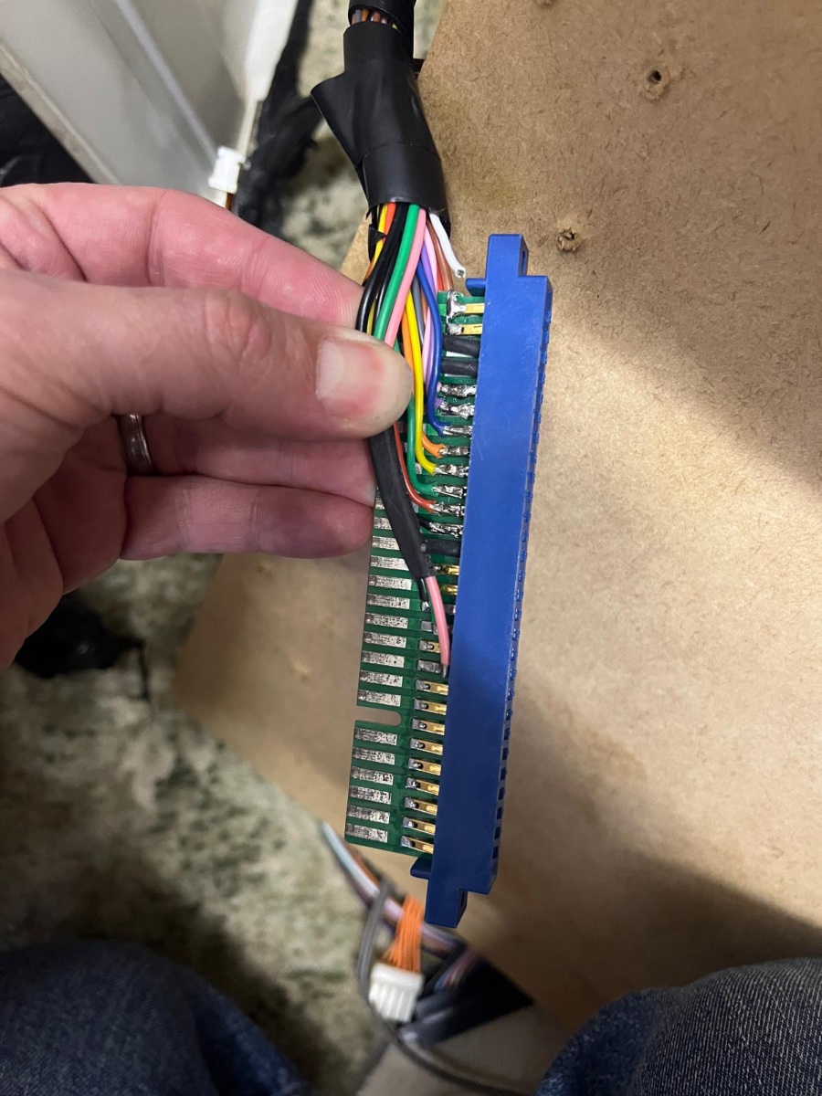

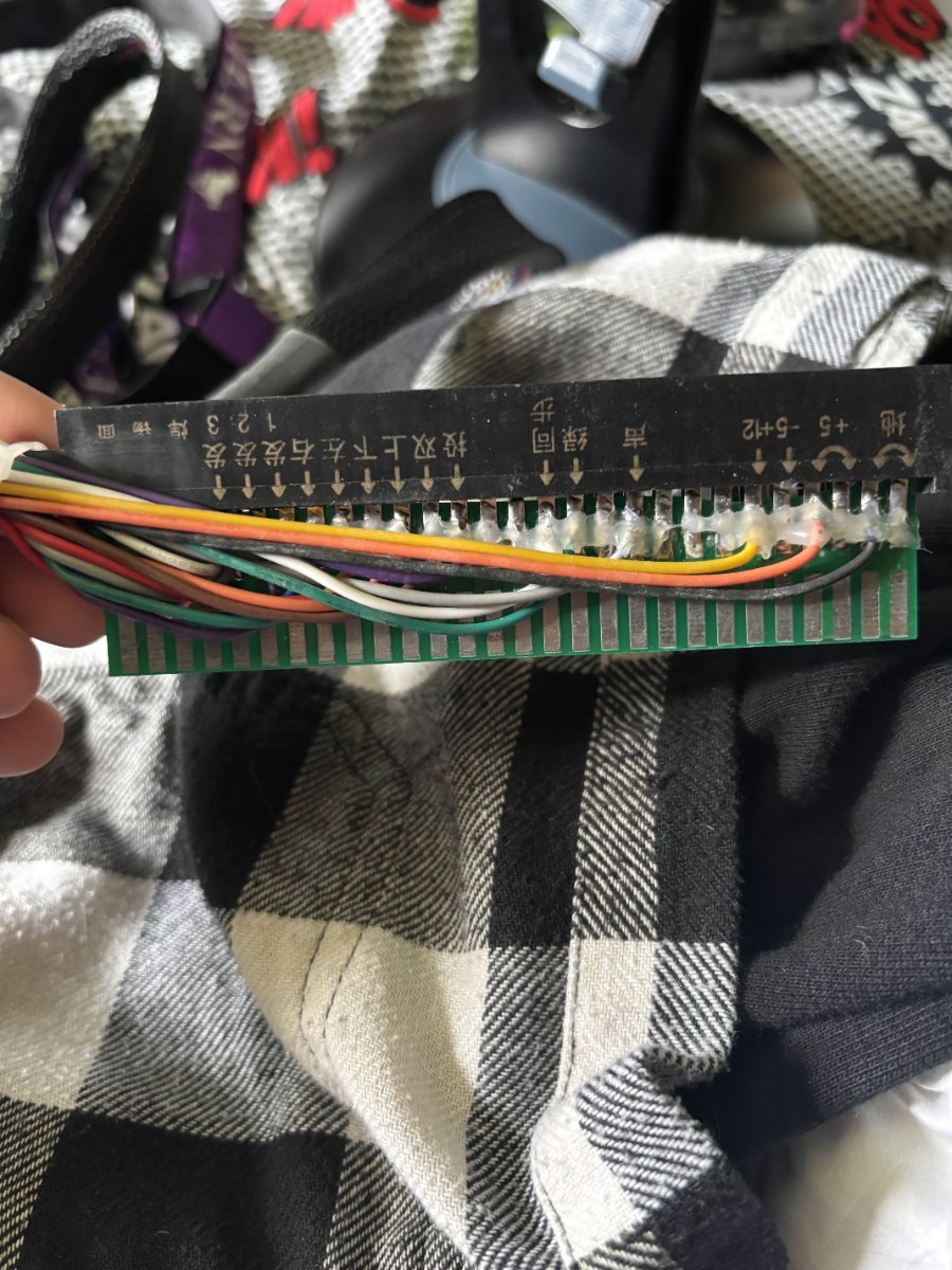

So I made the harnesses non chamma, and I'm still getting the same issues, another thread mentions how the monitors are grounded, should they both be sharing the same ground/sync wire?
Here's how my VS cable is wired if it helps (glad I checked, noticed the universal ground cable is broken!)
Looks like your cable is missing pin 14, video ground.

Oh my god you're right... Thank you for catching that I dont know how I kept going over it! I'll fix her up friday when I'm in and report the details
