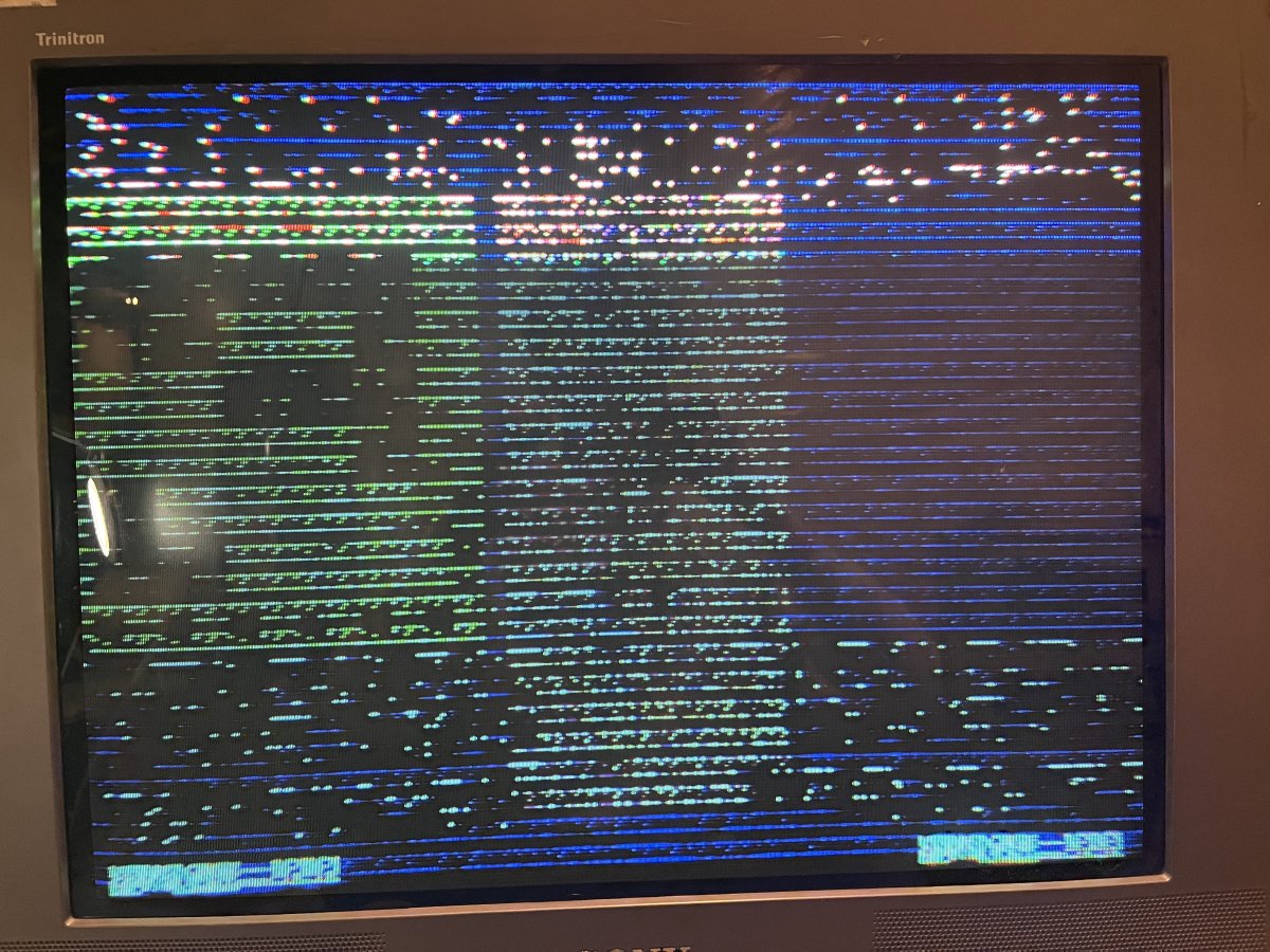

I recently got a kof 2003 cart I’m assuming has a failed neo cmc chip. I was wondering would my best bet to fix this be to source a game like kof 2001 and sac the chafio board off of it?

That resistor you see of 161OHMs is OK also all other 561OHMs if they still measure that value. If you can check any partial image on the screen your CMC50 is probably OK, and probably is just some lines between C ROM and CMC50 has a faulty connection. But in case everything is a mess on the screen then I would ask you to exchange the M1 Eprom because it is the center for "CMC50" decrypting all the Cx ROMs and S1.

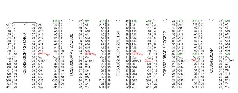

Well, if you extract the C/V Roms from the board for reading, they are MASK ROMs of 64Mbit (8M x 8 / 4M x 16) compatible MX23C64010 64Mbit (4M x16) from Macronix MASK ROM.
The others you can follow this :
Original reference: https://servimg.com/view/15705655/320
Regarding the P1 and P2 Mask Roms, in general, they are 32Mbit (4M x 8 / 2M x16) but can be 64Mbit or 32Mbit, depending on the manufacturing time. For example, I do have a Samurai Showdown 5 Special that was supposed to come with 2x 32Mbit P1 and P2 but instead arrived with 1x 64Mbit (P1) and 1x 32Mbit(P2), at the 0x40000 was filled out with 00s.
Regarding the P3 is a normal EPROM I suppose, can be 27C800 or 27C160.

If any of your Rom readers cannot read the correct version of it, I suggest you try to create some kind of adapter between the device your reader is capable of and the original MASK ROM. Also because all the ROMS are 5V you don't need to worry about it. On the latest games, more precisely in SVCChaos, Mslug 5, and KOF 2003 cartridges (boards PROGBK3S / PROGBK3R), you will see a 3.3v power regulator (48M033F), that is required only for the NEO-PVC chip and previous boards don't have it.

About the Character Board, it's clear on screen, if anything happens to the Cs you will not be able to decrypt, if anything happens to the M1 you will not have sound (CMC42), or not have decryption on screen and sound together (CMC50).
If you have some scrambled image information and can hear some sound from the game, but not all the graphics be ok on screen, then you will probably have some lines between the CMC and C Roms that may be suffering from bad welding that decayed over time or the Rom itself get burned.
