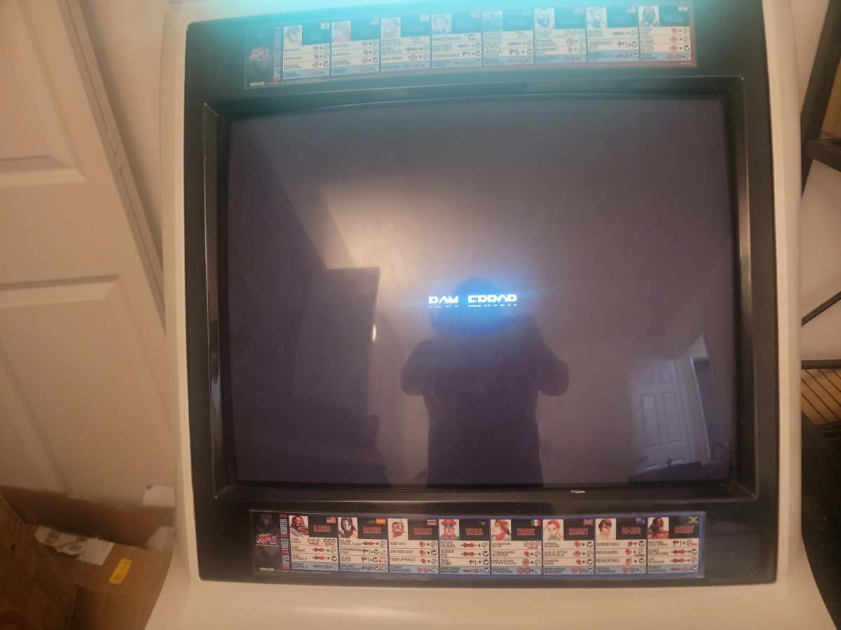

So, for the CPS-2 (or at least mine), the hardware crashes almost every time when playing on the HAS. I've been getting either a "RAM Error" or "NG RAM" error message (as seen in the picture attached). After getting the error, I either have to power cycle the system a few times and/or disconnect/reconnect the A & B board to get it working again. The voltage that I set for the PSU is 5.1V. The HAS voltage measurement is 5.04V.
