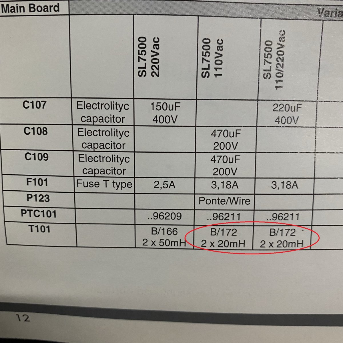

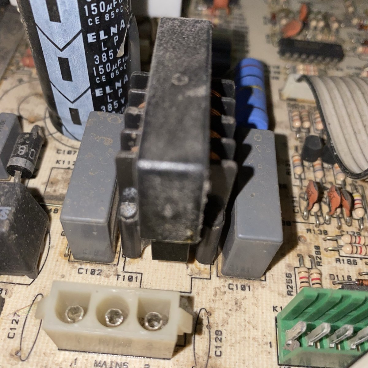

I got a couple of SL/7500 chasis (italian sort of Hantarex Polo 2). They work great, colors are vivid, nevertheless, both are working at 240VAC. According to the service manual, by changing a few components, it is possible to have them working at 110/120VAC. One of those components seem to be a small power transformer (T101) (attached image).
To be honest, based on what’s on the manual, I don’t even know how to look online for the replacement part (attached).
Any help to clarify how to look for this component will be highly appreciated.
