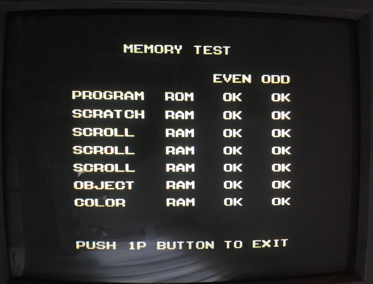

I got this board today and trying to figure how to enter in the test menu to see if everything is working (the game seems to run fine from the attract mode). I've tried some combos at startup but only holding the service button I get the squares pattern but nothing else. Am I missin something?
sk8er000
Mar 1, 2016
454
352
Italy
The p1 button 2 was always pressed due to a broken JK-03, I've bought and installed 3 repros from @caius and now I'm able to pass the screen by pressing p1 button 1 and run all the tests!
