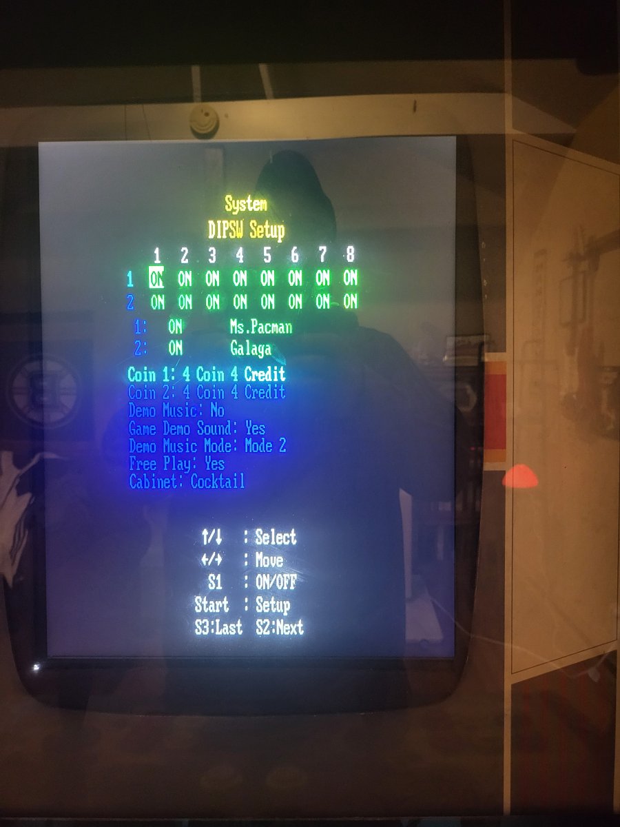

Rewired my jamma 60-1 cabinet. When I start it in test/menu mode my player 1 joystick and buttons work fine. In play mode only player 2 works. Player 1 and player 2 start buttons both work as well.
Wiring is correct I triple checked. Could this be a menu setting?

Welcome! If everything works in the test menu, I'd assume the issue is with the 60-in-1 PCB. Did P1 work in-game before you rewired? Any chance you have a different Jamma board you could test with?
Thanks!!! Not sure it's the test menu its the menu attached. It worked fine before. Just seems weird that everything work fine when I'm in this menu but not when I'm in play mode. I did mess around with these settings...It's not a cocktail
