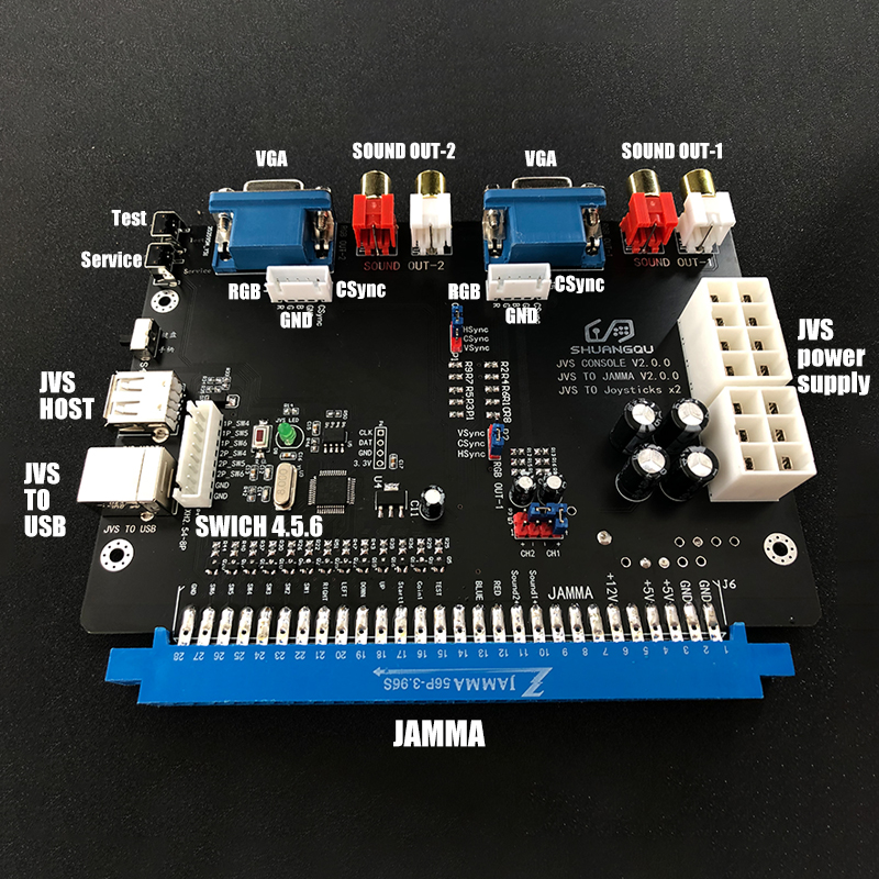

Axun works Jamma to JVS seems dont have picture picture cleaner like tri sync helper.
