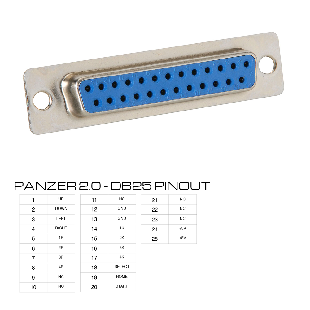

SNK-NEO-GEO Enlightened Joined Jul 21, 2015 Messages 3,631 Reaction score 2,667 Location Virginia Jun 15, 2017 #1 Hello.. does anyone knows the DB25 pinout on Jasen's Panzer 2.0? looking for that info.. thanks

SNK-NEO-GEO Enlightened Joined Jul 21, 2015 Messages 3,631 Reaction score 2,667 Location Virginia Jun 15, 2017 #5 great.. thank you... let me paste here for reference to others.. Attachments PFS2DB25.png 376.6 KB · Views: 300
