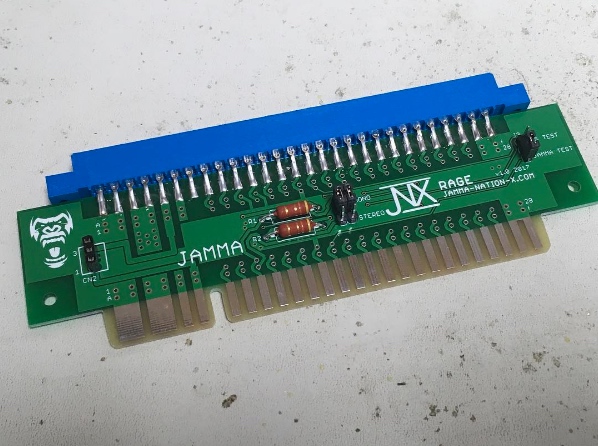

The JNX Rage is a JAMMA adapter for the Primal Rage Arcade board.
Pictured is v1.0.
-Supports Negatron to add -5v
-Test Switch moveable via jumper (MVS or JAMMA)
-Supports Mono/stereo sound, selectable via Jumper
Coming in v1.1
-CPS1 and CPS2 Kick harness Support to keep proper button layout.
--A--B
--C--D

Beautiful! Thanks for making these. I'm definitely in for one when they're ready.
Are the holes there to line up with the filter board's standoffs?
Unfortunately no, If I was to do that I would need specific dimensions and measurements, my PCB didn't come with the filter board or the metal plate.

According to DHL tracking, JNX Rage PCBs are due in on March 6th. I'll post as soon as they are available. They might be available here before they are put in the store or on ebay.
If you don't need the kick harness support added in version 1.1 then I will be selling the older version 1.0s on ebay for pretty cheap since I don't want to waste them.
Version 1.0
A--B--C--D
Version 1.1
A--B--C--D (4 button setup w/o Kick Harness)
A--B--X--X (4 button setup w/Kick Harness)
C--D--X--X
For the 4 button setup using the kick harness, keep in mind that if you have the Neo D(JAMMA 24) wired to the short kick(for some reason) you will be activating both C and D at the same time, this of course can be fixed with a simple trace cut.
