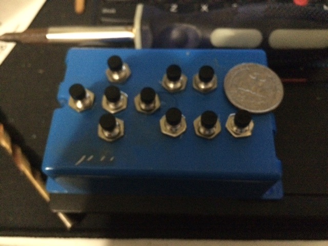

Photo snapped with a quarter laid on it for size referencing. Necessity is the mother of all invention.
I find myself making some side cash these days helping ppl out with their arcades machines. I really need a test bench to be portable and flexible. I don't want to lug around with all kinds of crazy stuff. I also don't want to spend too much on a test bench.
I find a great many unsalvageable arcade cabs. Often, the monitor ISO transformer, switching PSU, line filter, fuse box, JAMMA harness are fastened down on a 12"x15" wood plate. I just remove the plate and it makes for a perfect portable starter test bench with all the wiring. But now I need to to navigate to the test menu because the same test bench I use to calibrate my monitors (CPS2's test patterns are my go to for calibrating colors). No point wasting one of my arcade sticks for that. I had even thought, maybe using a spare cut corner CP' I have laying around. But no point wasting that either. Plus it isn't very portable.
So for about $7, about a 2 week wait for the switches to arrive from China, and a short trip to Home Depot to pick up an electrical junction box later, I think I have what I need. Whatch guys think?
Works for me, for years ago used to have the exact same setup but used a project box from DigiKey, along with some DB9 connectors and cables. Then I kept breaking switches and went with a cheap megadrive repro controller :P

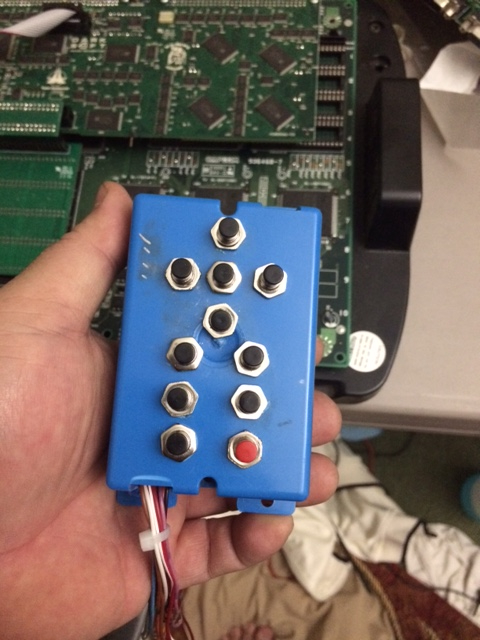

Finished it off. Works great. I am able to hold it in my palm and navigate with one hand. That it is wired and not bound to the JAMMA edge gives great freedom of movement. Perfect for test bench purposes. Red button is the TEST button. Will add a cover plate to this later.
Harvested a TV speaker from one of my CRT tube swaps for this purpose and it works perfectly too. Will figure out how to mount it cleanly on this board as well. Salvaged an AC switch from a damaged cab too. Allows me to turn the thing off and on as needed. Last thing I did was removed unused JAMMA pins from the edge connector (2nd player, counter, etc). Keeps all the wires nice and clean.
I might even add a handle to this so I can lug it around to and from site locations.
