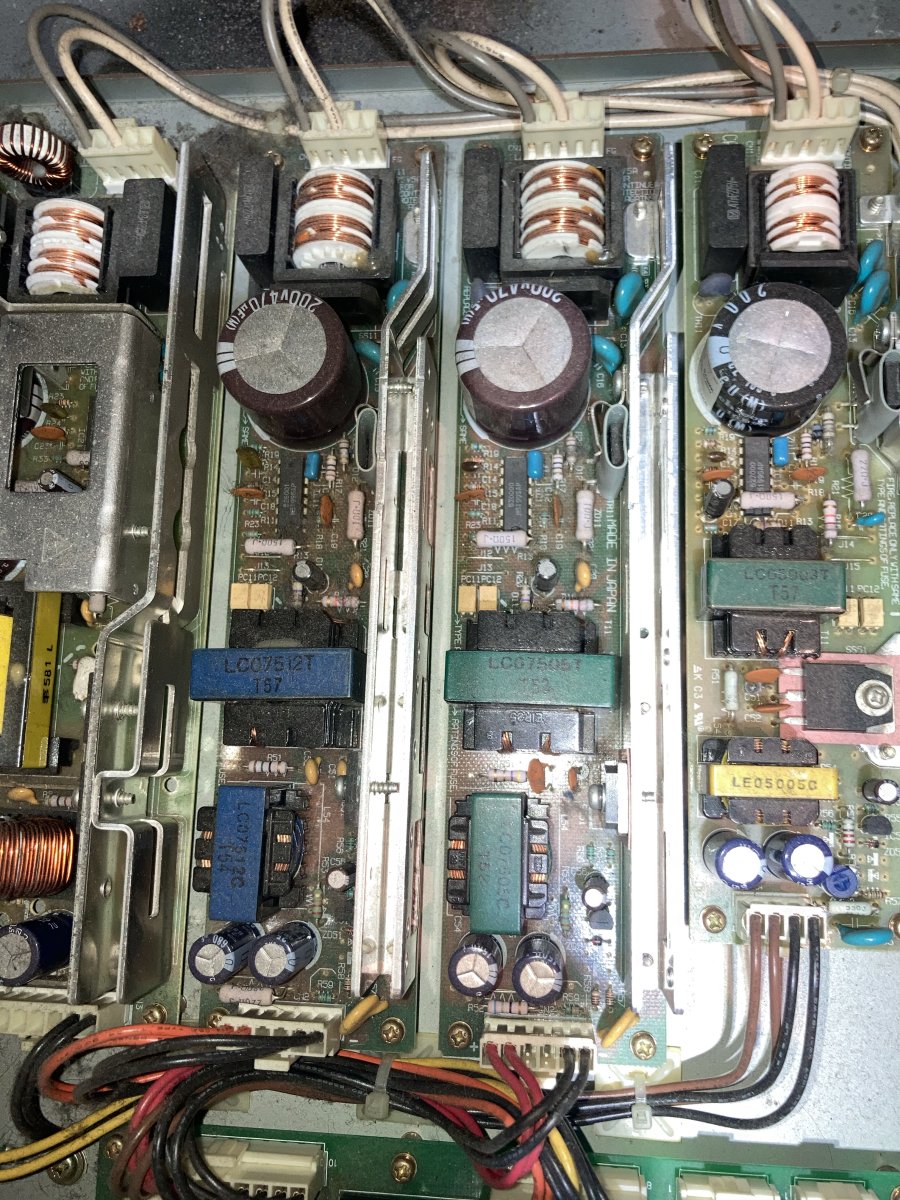

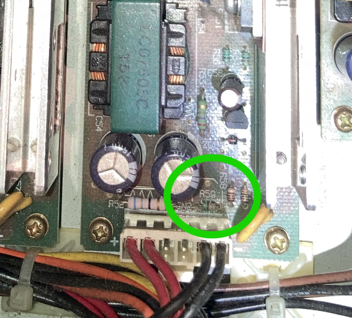

streetfighterken Grand Master Joined Jul 21, 2015 Messages 738 Reaction score 457 Location Sioux Falls, SD Jan 6, 2025 #1 In the pics you'll see there is a pot for the 3.3v, but no pot for the 5v; just a resistor instead. I'm reading 4.7v but no way to adjust it on this. Has anyone installed a pot on this type of PSU? Attachments mario kart psu.jpg 325 KB · Views: 72 mario kart psu closeup.jpg 273.7 KB · Views: 65
nem Immortal Joined May 29, 2016 Messages 7,731 Reaction score 8,453 Location Finland Jan 27, 2025 #2 I just went through my PSUs, they're unfortunately all the same. Just a resistor where the pot should be. The model number for the one with the pot is LCA75S-5-Y.
