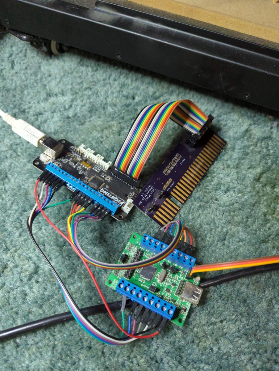

Second (and maybe 3rd, 4th, etc), @Mrhide - I'm having a real bitch of a time with my Chewlix and 2nd player. Mine didn't have a 2nd player harness, so I bought a new one (for chewlixes) on ebay and it came in today. I tested continuity on it and it works 100%, there's no issue with the physical harness. But when I connect everything for player 2 literally only one button (quick kick) is noticed. Not even directionals. I've tried setting it up on Batocera as well as Windows and it's the same thing both ways. In windows, the Brook boards show up as an Xbox 360 and Xbox One controller.

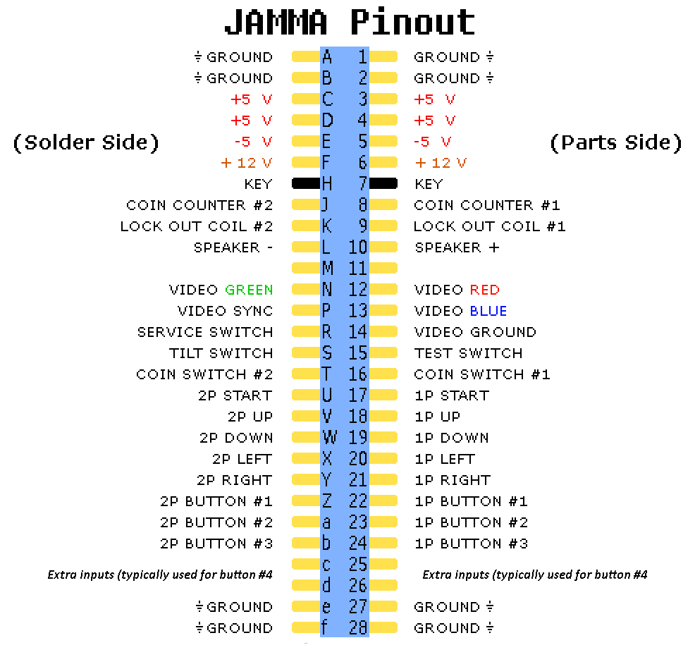

I have two brooks boards. One UFB (latest firmware) and one PS3/4 "green" board, also on latest fw. Both of them are connected to a Psychic Drive UFB to JAMMA adapter. Now here is the weird thing that I just cant wrap my head around.
Both brooks boards will randomly act like either a "Generic Xbox Pad" or some other such thing. I have to unplug the USB cable, and replug it and then Batocera says "Brook (whatever board name) connected." I can assign every button on my control panel for player 1. Directionals, 8 face buttons, start, and even 3 extra buttons you see up on the sub panel. The board I linked to earlier has a CPS2 connector that I'm not using at the moment. The board has a switch to go between JAMMA and CHAMMA. If I set it on JAMMA, almost nothing works, and only 3 buttons work for the kick harness. If I set it to JAMMA, the CPS2 connector basically shuts off and doesn't work anyway, but I'm able to assign all of those buttons in Batocera - albeit for ONLY player 1.
Normally id say "welp theres an issue with the wiring beyond the harness in the loom" - but (it gets better!) - Before, when I only had the P1 harness, I would move the molex connector to the Player 2 connector to test - and it worked fine. Granted Id be on Player 1s side, but activate player 2 in games, etc. But now - even that doesn't work anymore.
I'm seriously considering just removing the Psychic Drive board and then just wiring everything directly to the Brook boards. I am utterly lost and confused as to what is causing this issue so I'm thinking of just abandoning the JAMMA side of things and go direct to the brook boards, and even remove the Psychic Drive board.
Will it hurt anything if I just completely ignore the JAMMA harness in the cab entirely? Like when I turn on the cab it powers the PC as well as the monitor inside, and would normally power a JAMMA PCB if there were one in there. But if I completely take the harness out of the equation and wire everything directly to the brook boards, but leave the harness attached inside the cabinet - will that cause any issues in day to day use?
