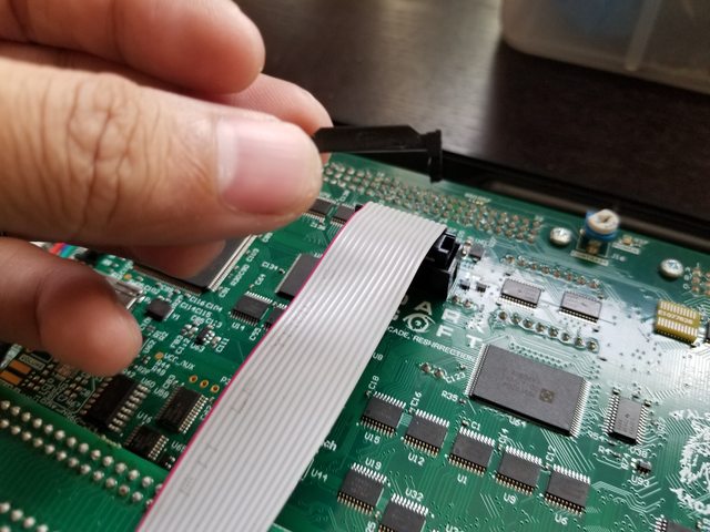

Now I'm just trying to figure out why the sound is getting messed up when I close up the shell for the B board.
UPDATE:
It looks like the area that's causing this issue is where the ribbon cable for the LCD screen plugs into the larger board for the multi kit. I cut off the specified supporting leg for the shell so it's able to close, but the plastic end of the ribbon cable sticks up a bit too far so it doesn't close all the way. When I screw it shut the sound gets to varying degrees of broken, so I'm just leaving it unscrewed for now.
Final update on this- I was able to remove this plastic piece from the connector for the ribbon cable. Afterwards the shell closed without any resistance, sound and graphics are fine. I'm all set!
