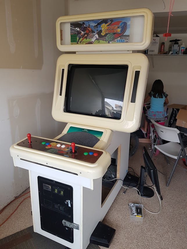

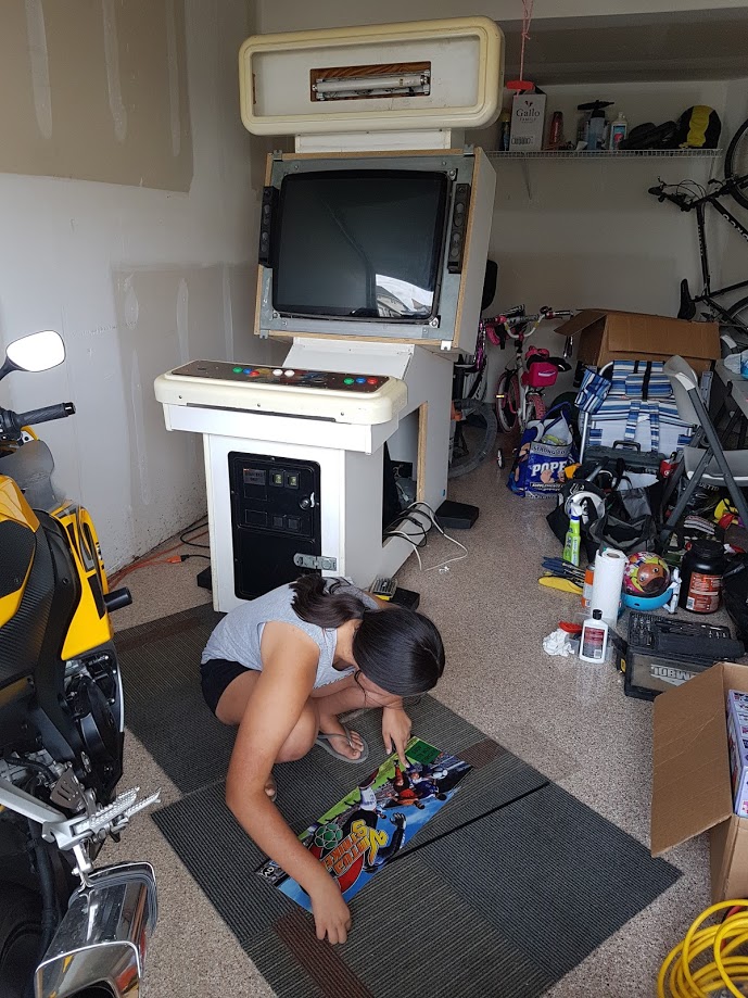

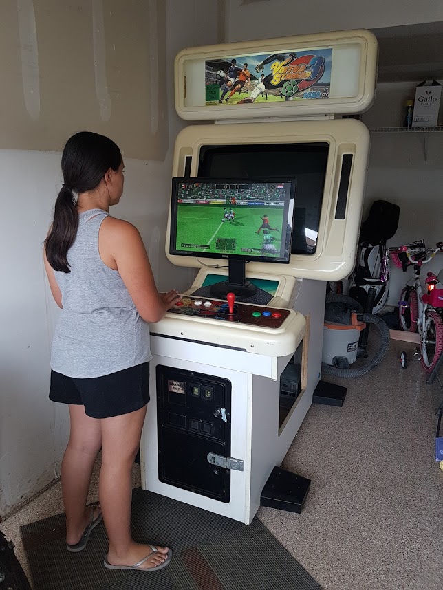

Hey I'm new here looking for tips on how to make this Father Daughter project more interesting for my girl.
So far we have cleaned it up and found that the monitor caught fire. So I'll be looking for a permanent replacement eventually, but for now I'll just be buying new games so it's not just soccer for us

Oh yeah, it was originally Virtua Fighter 3... but I am having a hell of a time finding a Marquee or anything in this size lol

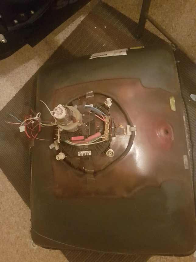

Can I see pictures where you suspect the monitor caught on fire?
when I got the cabinet home the monitor circuit boards and components were striped. but when I pulled it out I found a big scorch mark on the support and a lot of soot inside for me to clean

In regards to the monitor, unless the chassis is totally slagged, if the tube is in good shape, get the chassis repaired. That custom bezel will likely never look right with a 16:9 LCD in there, and finding another 33" monitor for it will likely be a chore, unless you can find a donor tube from a 32" TV (and then, you'll still need to have your chassis repaired if it's not working)

I think he said the chassis was gone. He could buy a replacement chassis. I'm not sure what model monitor it came with originally. Probably a Nanao. There are generic chassis you can buy to replace it but you may be stuck with 15k which will work with Naomi. VF3 was 25k which I don't think any replacement chassis are capable of using.
If someone could tell you the model of monitor in their VF3 cab you could maybe be a spare monitor chassis. That would be the best option honestly. A flat screen will never look good in that cabinet. I'd try to do everything to get that CRT working first.

This is the monitor, and all of the wires included with it
There aren't any local resources around here that I can find. I've been looking online even and haven't had any luck finding parts for this one
The only thing I've heard about these monitors is that the company is out of business and was rebranding a discount monitor (according to my internet search)
For now I've ordered a Mobile suit Gundam game to get me by until I can decide if I should do a CF mod or look for a netdimm and raspberry Pi

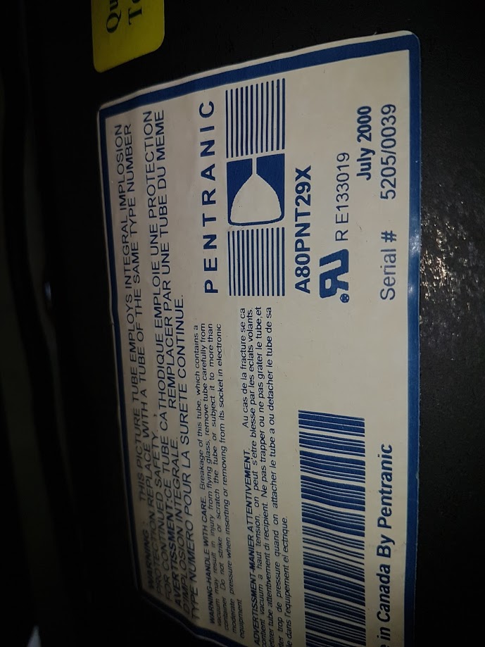

I couldn't see the tube label clearly, but do recall that it had a white label with blue writing like this. I'll see if I can get a clear shot by reaching up on there with my cell tomorrow, but suspect that we have the same tube. If so, then a d9200 chassis like I described above should get you going
the A## on the tube code denotes the size in cm
A63 = 25in tube
A68 = 27in (aka a Japanese "29in") tube
and this one is A80 which would be a 32in though I think this cab was advertised as a "33in"
I believe the D9200 did come in a 33in version but you'd have to find a 33in D9200 chassis to use and who knows if that's even the right chassis for this tube.
