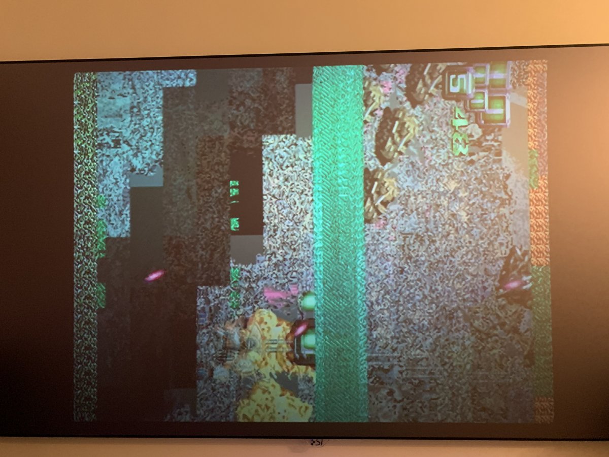

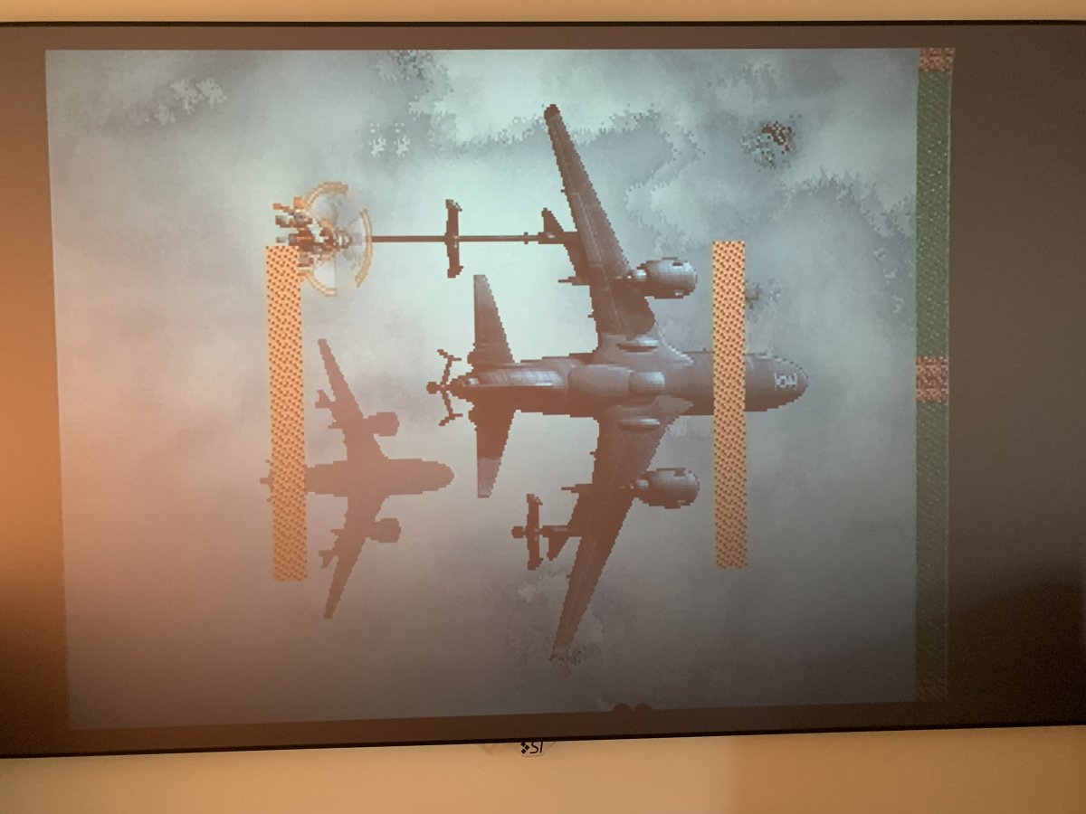

I bought a Ketsui cartridge for my PGM, but although it boots and is (arguably) playable I have a lot of graphical corruption on screen. (kindly see the attached photo).
Is there anything I can do to salvage this cart?
And yes, before you ask I have cleaned the contacts in the cart thoroughly. :)
Any suggestions are welcome.

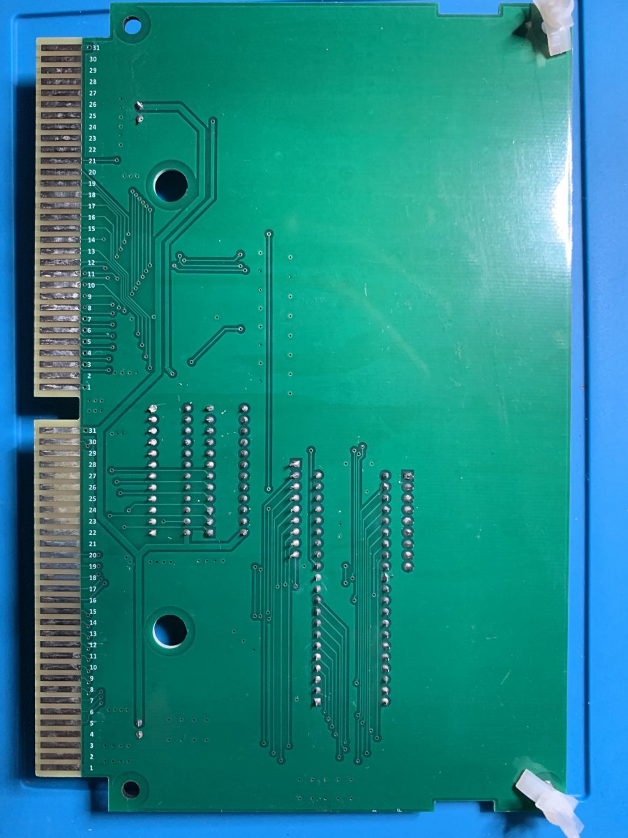

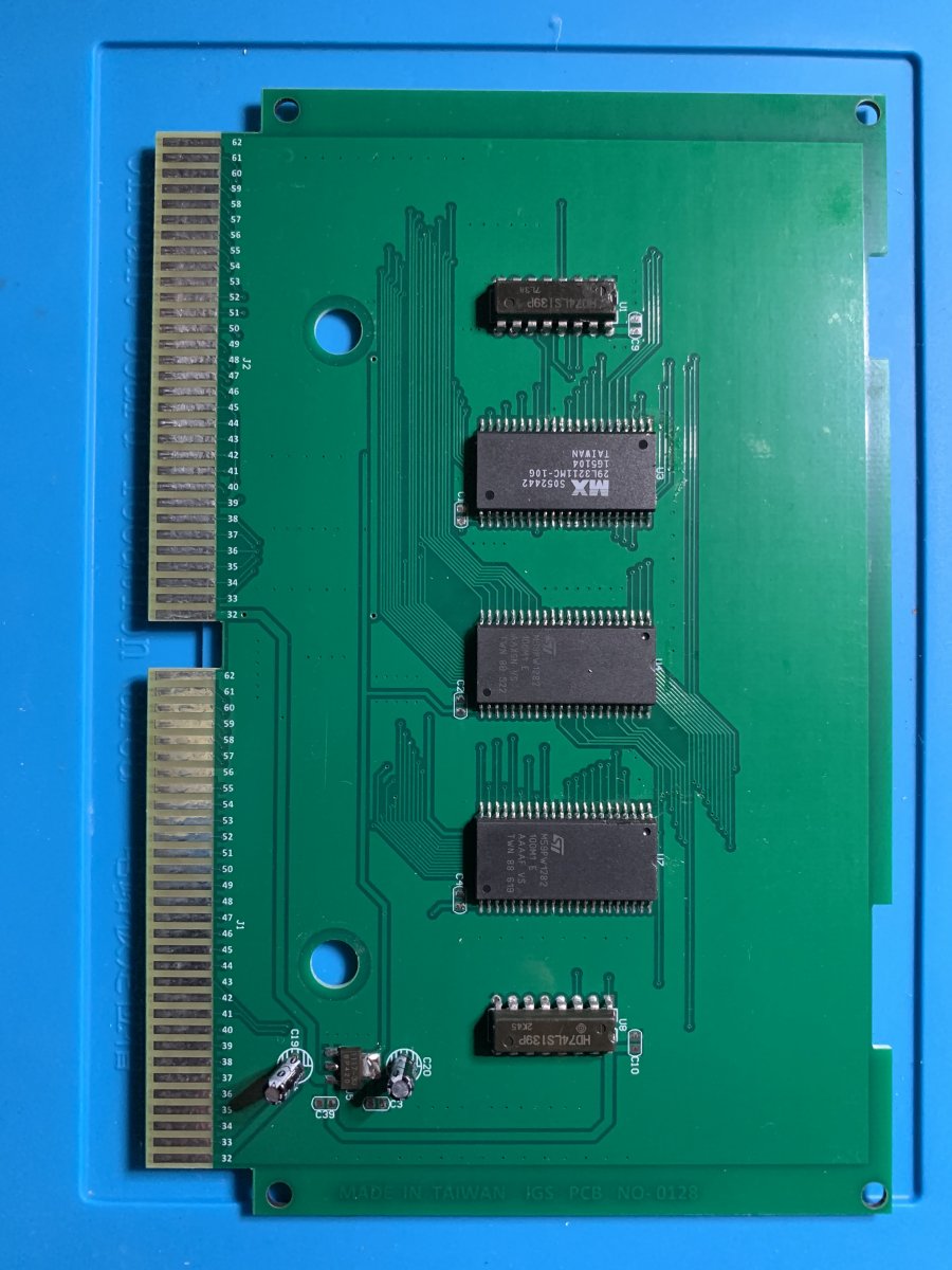

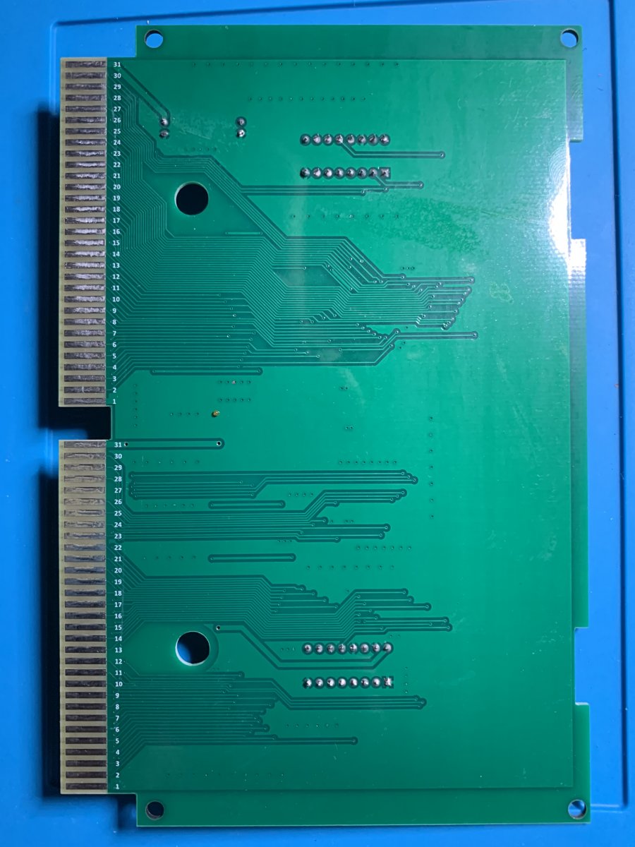

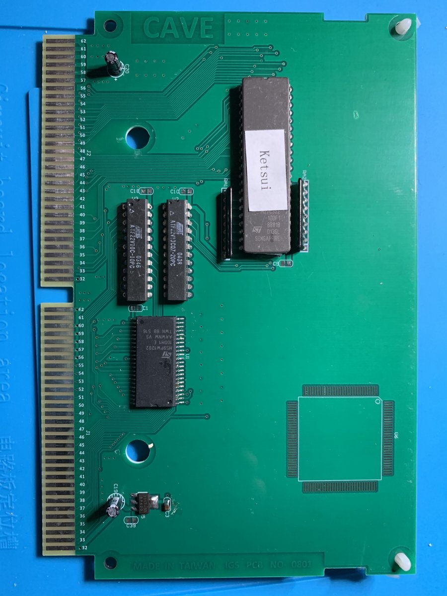

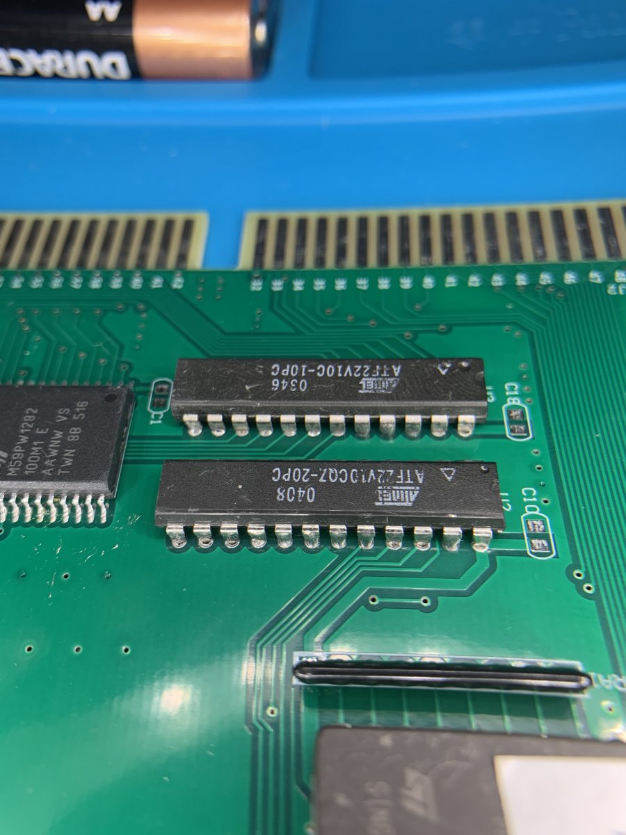

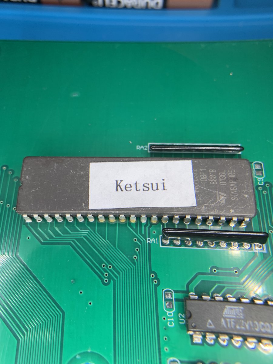

Post pics of the front and backs of the two boards in the cart, perhaps there’s something astray someone can pick up on.
To help troubleshoot, and as proposed by djsheep here are pictures (front and back) of both boards...
Curious to hear your thoughts...
Thanks.
Cheers,
Is all text corrupted? That would be the SMD mounted ROM on board1, or one of the GAL.
Most text is corrupted (the text with larger font seems to be displaying ok though).
I apologize, but can you please elaborate a bit more on your diagnosis? (for someone technically inclined (my education is in IT), but an absolute beginner at chips, soldering and boards)
Thanks
the gold contacts need a good clean with some alcahol

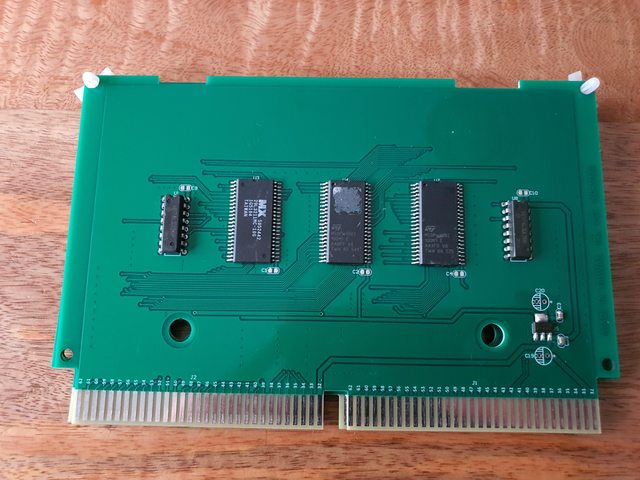

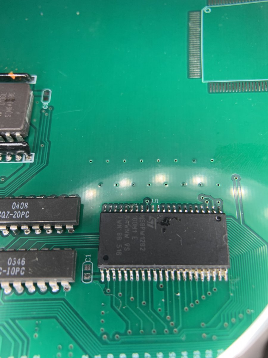

and a higher res picture of board1 front - the smd memory has "interesting" soldering!
I've already cleaned them twice... the cotton buds are coming out clean now... :) But I'll do it once more, for good measure.
Regarding more pictures, here they are.
Please note some may be slightly distorted as I took the picture through a magnifying lens.
Happy to take more, if you feel may be useful.

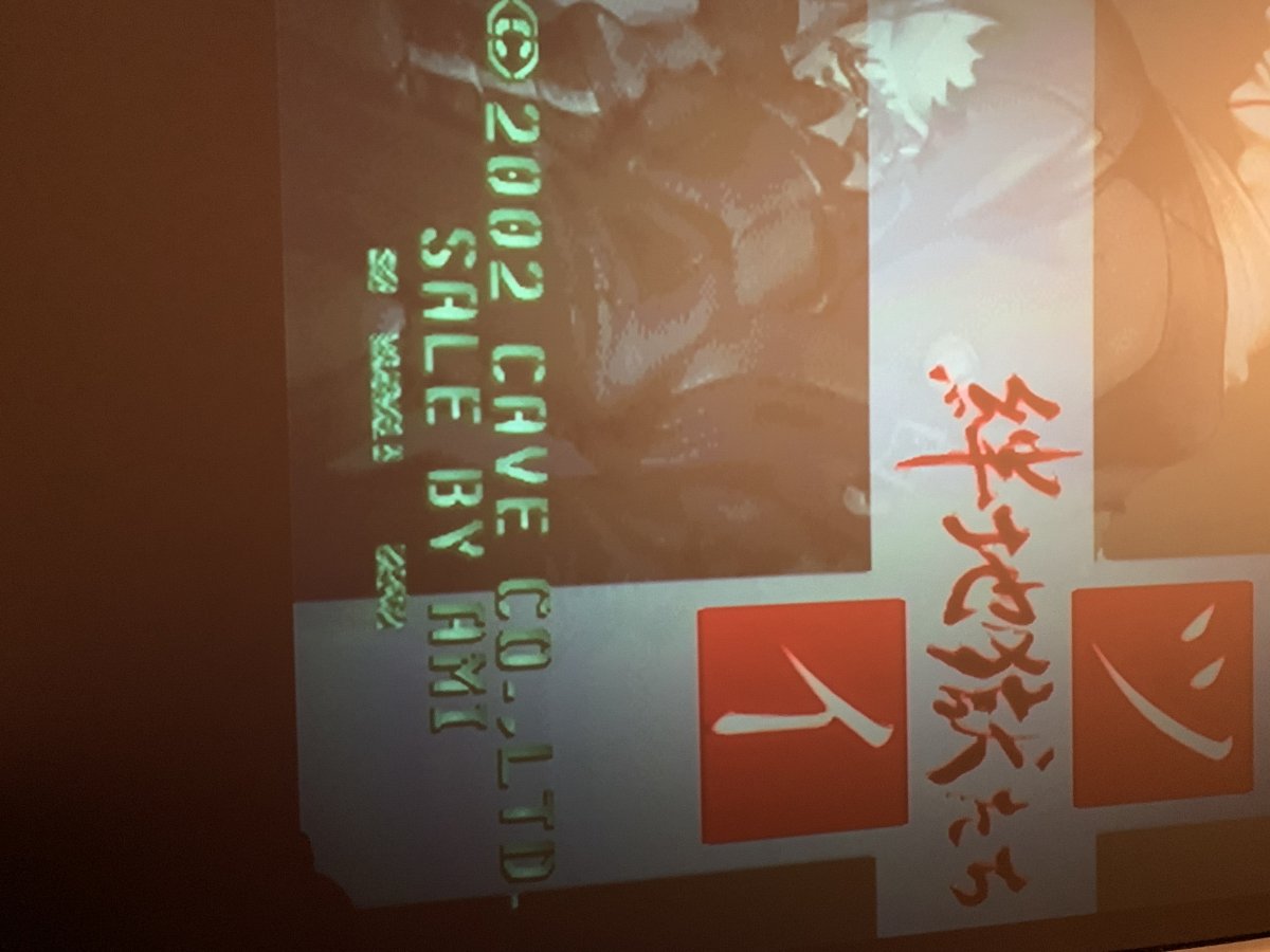

Thanks
The big EPROM on board1 is program code, the SMD mounted one is the tile graphics (text and background). Board2 provides sprites and sound samples.
I assume the background looks fine? Then I expect the chips are not totally broken and data lines are fine. I'd look for problems on the address lines, both on the ROM and the GAL.
Thanks for the explanation.

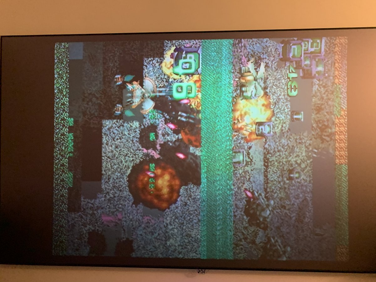

Now that you mention it, the background gfx also seem to be corrupted (more photos attached).
Does this mean that the SMD chip is bad? Or is there something I can do to try and remedy it?
I'm disputing the sale on Aliexpress and they have offered me half the money (and I keep the cartridge) or full refund (minus shipping) and I have to return the cart.
I'm trying to assess if this is something I can take as a project and keep the cart, or if it's a lost case and I should return it in full and loose the shipping cost.
I'm quite new to the hobby, but I'm looking to improve my soldering and troubleshooting skills :)
Could be, could also be the voltage regulator (does it produce 3.3V?) or one of the GAL. Or it could be a dodgy solder connection.
That is up to you - there are no "unobtainium" chips used, though so far I haven't worked out the equations for the GAL if they need to be replaced. The problem with this and other conversions is that they use 3.3V chips in a 5V environment. That could work fine for ages, or could fail. Many people play with them without problems.

FWIW, I think you should just return the cart. I think it's very likely that one of the SMD flash chips is bad or was programmed improperly. The PGM mainboard is feeding 5.0V of current into flash chips rated for 3.3V so all bets are off on how long the parts will live. It could damage your PGM mainboard as well.
