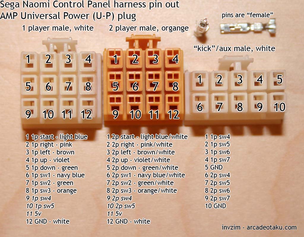

Hello all, I got this from arcadeartshop and I think it's wired wrong. Only one button works on P2.
From what I can see, the GND is wrong for P1 and P2 (in this photo 2nd on the left). The 2 diagrams I have managed to find support this.
Anyone else got experience of this?
Yep you can depin and move the wires around I also seen adapters on some cabs that would change the kick/aux pinouts for astro blast to Naomi/NC/NNC.
The housing will fit both they just changed the wiring around, honestly not sure why tbh lol.
I didn't realise Astro was different. I've got Naomi Universal, so I'll swap those wires around and try again. Thanks guys.
