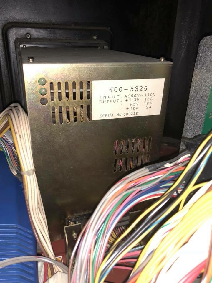

What’s is this spitfire I keep hearing about? My negatron is one that was recommended to buy when I Bought my adapter they said to get one from dimensions engineering.
Should be fine. I run it on a blast with a negatron too
