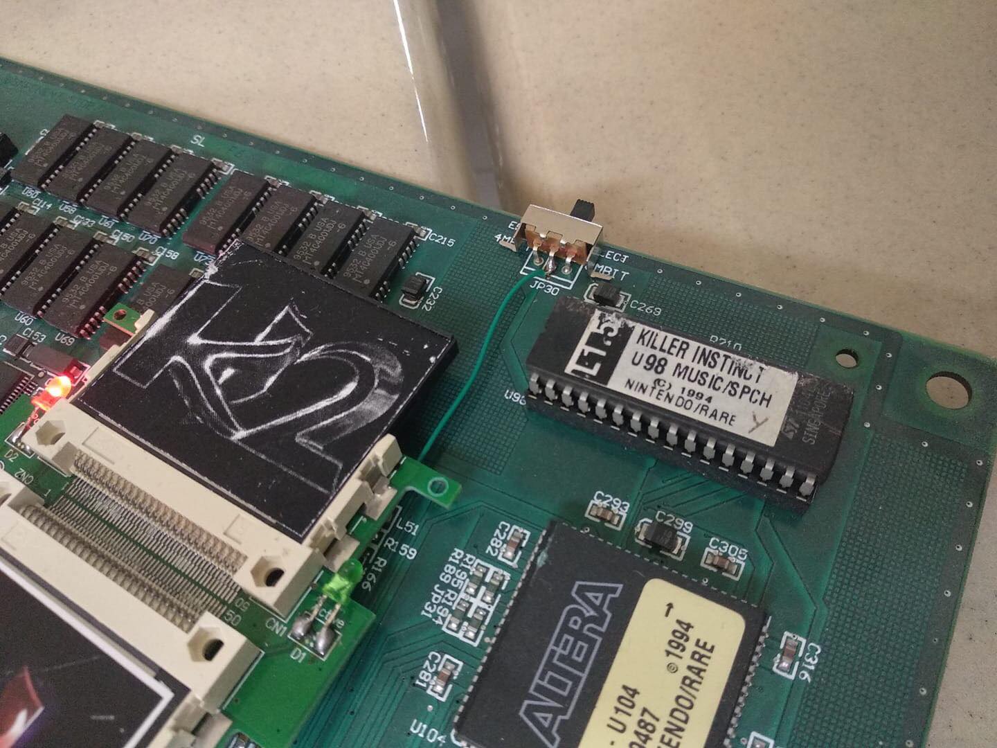

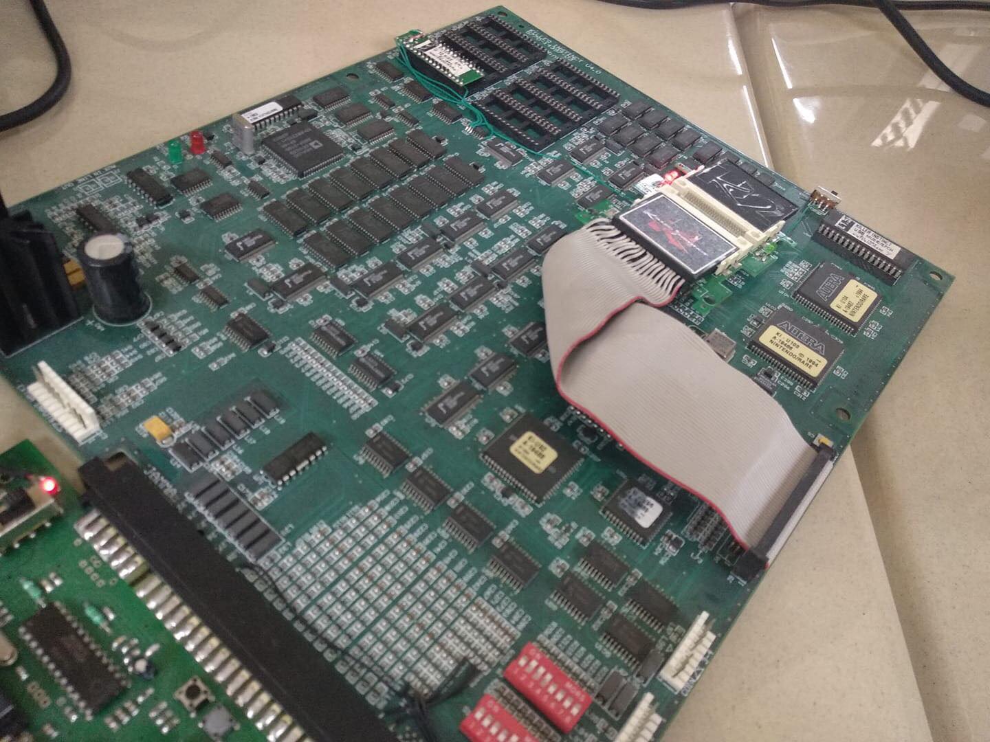

Anyone seen this? This guy in russia is running both KI1 and Ki2 on the same board using a switch.

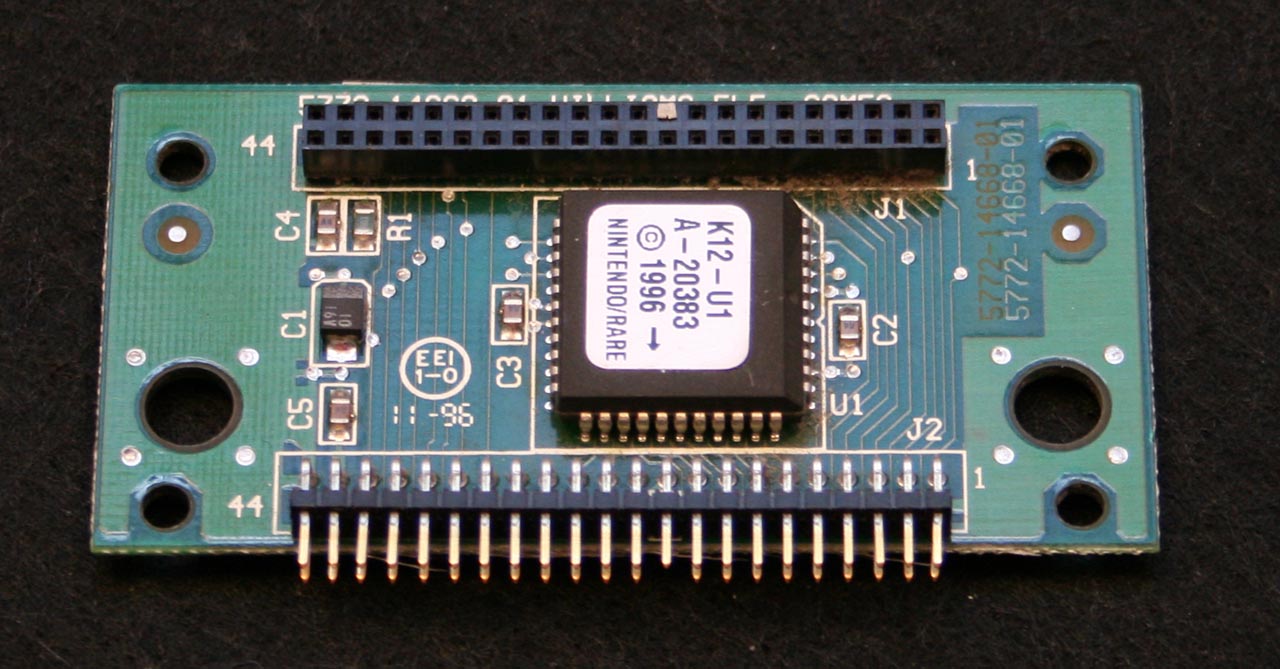

KI1 boards can be upgraded to KI2 with a special add-on board. So there shouldn't be any reason they're not switchable other than having to have a double size boot ROM.
As in the picture above, a switch can be installed to go between the 2 versions of the boot ROM and then you just need a solution to have the 2 different drives with game code connected. That's a nice looking solution.
the base hardware is the same but there are a few things to convert one KI1 to KI2 or visa-versa
-the 8 Sound ROMs need to be swapped
-the boot ROM needs to be swapped
-the IDE data needs to be swapped
-the IDE controller IC needs to be swapped.
all of those are plug-in swaps except for the IDE controller IC, but that's what the official KI1-> KI2 adapter is
it's just the KI2 version of the IC on a board setup to bypass the one on the PCB. theoretically you could convert a KI2 to KI1 if you had this IC mounted on a similar adapter board.
The key for a multi board would be to modify the boot ROM to work with either one of these chips, and maybe pull one or the other game off of the same IDE device. then you'd just have to setup sound ROM bank switching.
