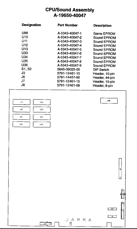

ROMs are bootstrap, sound and music. All program code is stored on the HDD/CF card
I guess Midway was wrong
I always thought the HDD/CF only held the pre-rendered video cut scenes.
No. U98 stores the bootstrap code so it is very much the "Game EPROM" - without that there's nothing to tell the board how to load the data from the HDD.
Understood.
