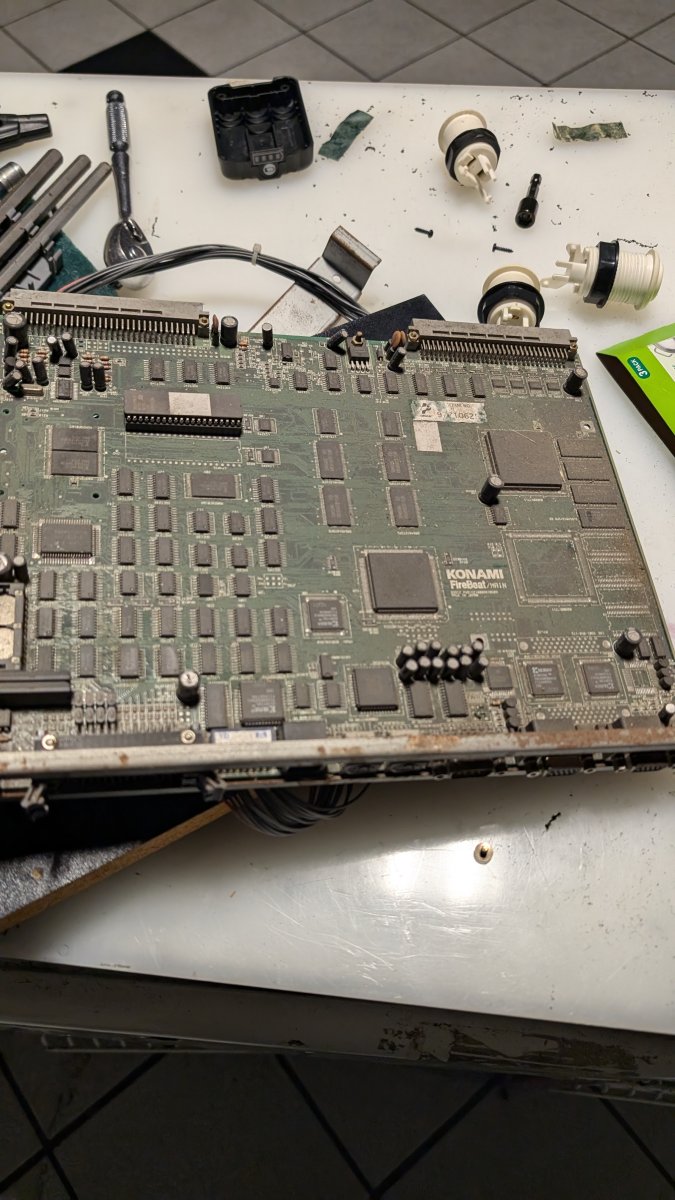

Hey, so I recently picked up a Para Para Paradise cab with a Firebeat system. Seller says it doesn't work, and i haven't tested it to find out. I wanted to go over everything before trying to fire it up. I'm not familiar with this system at all, but once thing I've noticed is there are no discs in either drive.

Firebeats can be a bit of a nuisance at the best of times and in this condition I'd be setting my expectations low. Can you take some closer shots of the PCB? From what I can make out I'm seeing quite a bit of rust.

Worth noting the vrams have a tendency to go bad. A local has two firebeat stacks for a keyboardmania and both seem to have faulty vram (hopefully just that).
Best of luck mate.
welcome to the sad firebeat owners club! I have two for keyboardmania that both are failing to read CDs. :)
discs for the Firebeat games can be found in mame, however it doesn’t look like you have a security plug so with some use of python and a google for “firebeat patches” you can crack the discs on your own and they’ll work.
