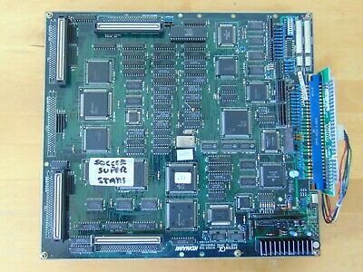

Nice what's the other rom board?
Some of the more advanced games output the video from the rom board and need a 'video' loom / extra jamma adapter.
The golf one i included that mounts underneath and does not need that.
