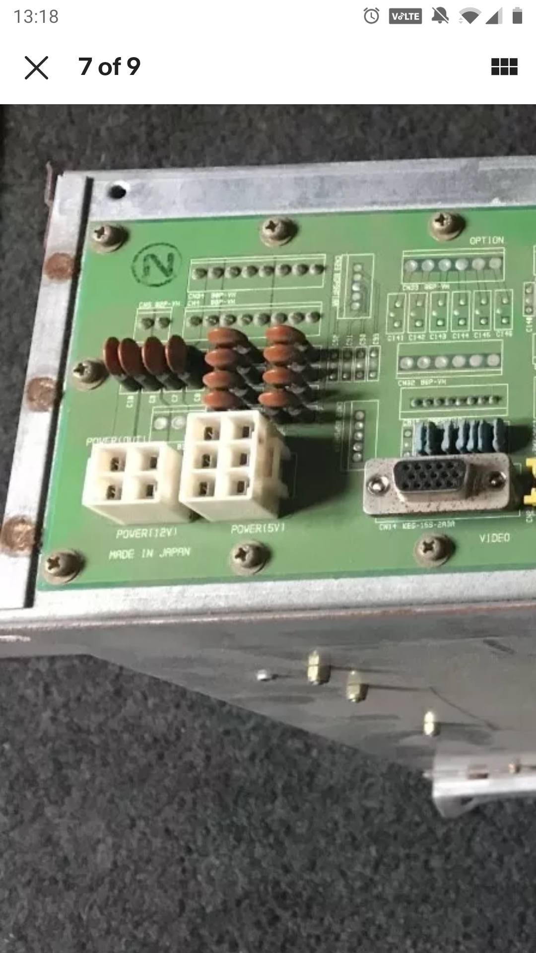

I'm trying to figure out the correct power pinout for this filterboard. This is the same filterboard used on Silent Scope. (pic attached to post)
I mention this separately from Gradius IV and NBA Play by Play because they have different filterboards, with different power connectors (Looks more like Sega Naomi connectors)

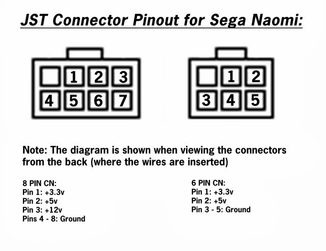

I assume the Teraburst/Silent Scope is similar to the Naomi pinout without the "left most pins".
Can anyone confirm? I'd like to be sure before shoving power in unknown places.

There's a manual for this that shows the wiring but not in its best quality. I do have a scanned manual from the upright version which I will upload in a few hours: http://antelopearcade.com/files/Arcade Manuals/TERABURST.PDF
CN1 and CN2 are the power connectors. CN1's pins 1-3 are +5v and CN2's pins 2 and 4 are +12v. The rest are ground.
Oh...and this game isn't JVS. It uses an m68k based I/O board located above the CPU board with the main CPU, a Power PC 403GA, communicating with the m68k via a latch.
If you need a custom power harness I can probably make one for you. I had to make a bunch for a project and have some spare parts.
I have the 6 pin connector, the 4 one possibly. I can crimp leads for you to length you need to make your own harness.

I made a crude drawing of the connectors on my phone. Let me know if this is correct.
@Derick2k - I'd be happy to take you up on your offer for the power connectors.
@Hydreigon - Can you confirm my drawing is correct? I wasn't really sure about the 4pin CN...
