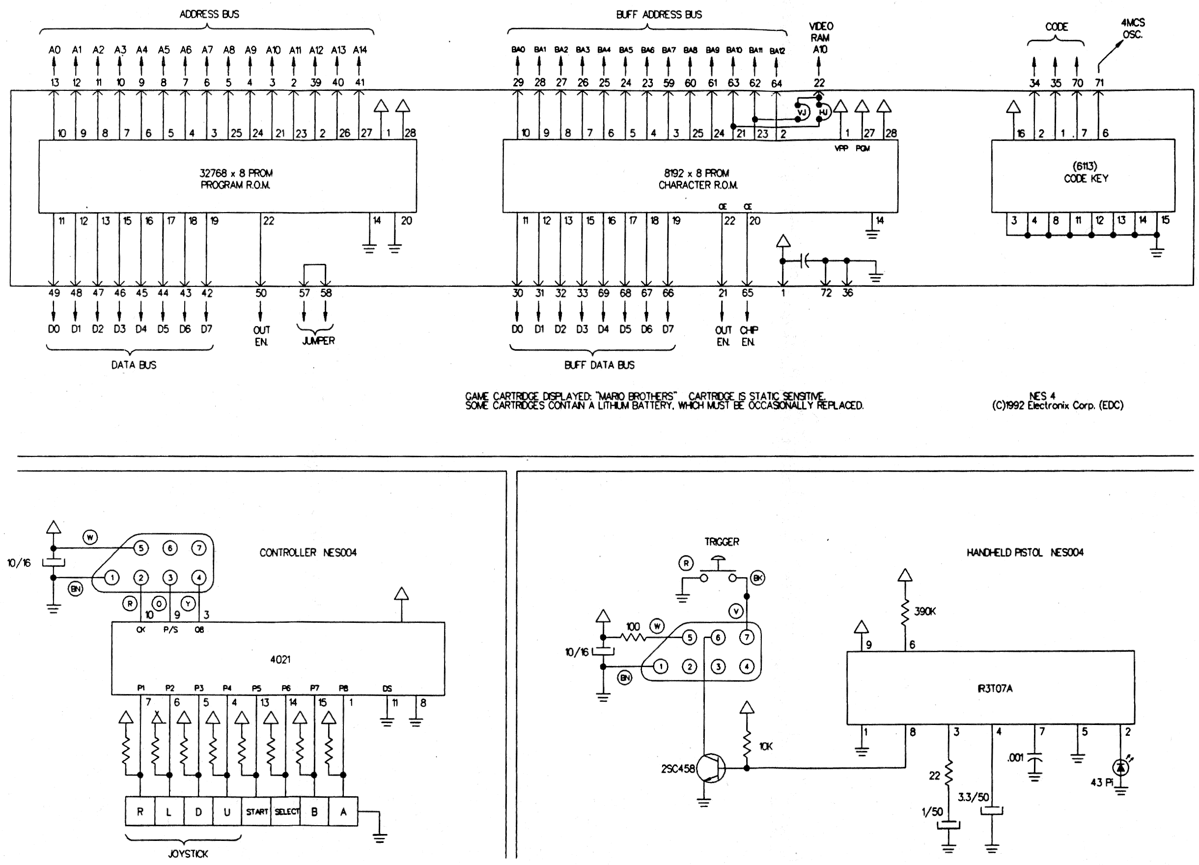

tried connecting an nes zapper and it didn't work.
no cabinet just 29 sony crt
how did you connect the nes zapper?
it should work without much work.
maybe the sensor output needs to be inverted.
either use a 74ls04 or 74hct04 chip, or try bypassing that transistor on the output.
