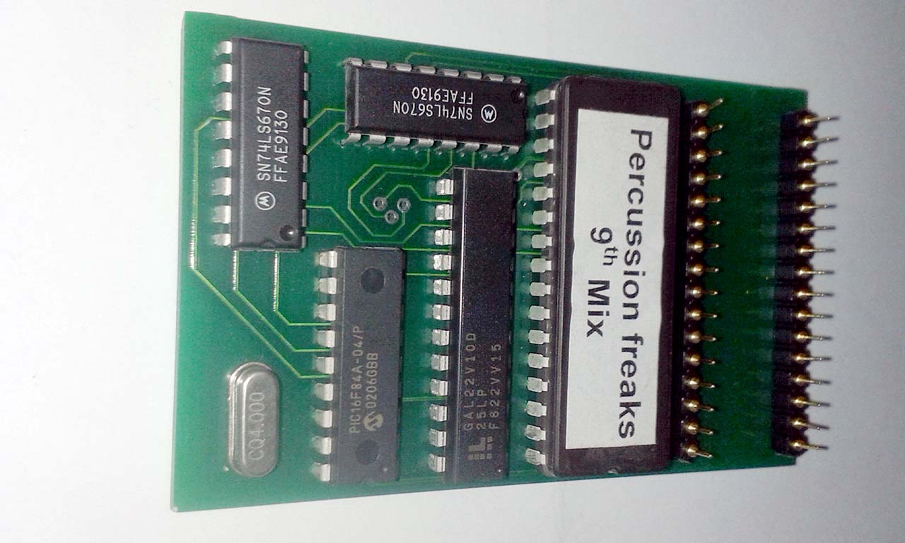

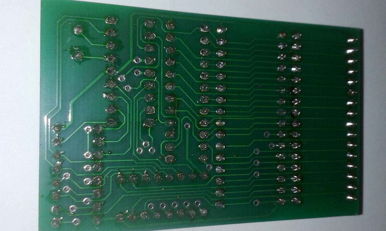

It has a mod board, but it looks a quality unit. Percussion Freaks 9th.
can you take photo of this mod board?

Dion, here are photos of the mod board...
I have seen mod board like that. not quite sure how they works.
