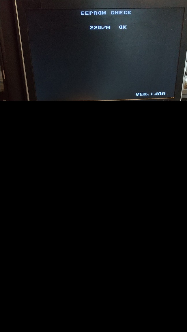

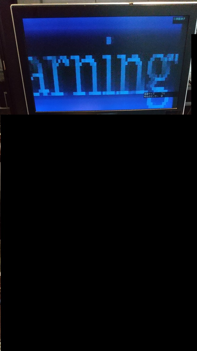

I have a Konami System GX board that was laying in the repair pile but I had no idea what was wrong with it. After power up without a rom board I noticed that it was just static garbage and resetting. I tracked that problem down to the motorola cpu and replaced it. After that, the system would go through its "Warning, sub board not attached..." error like it should.

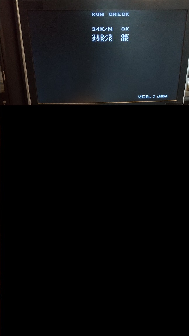

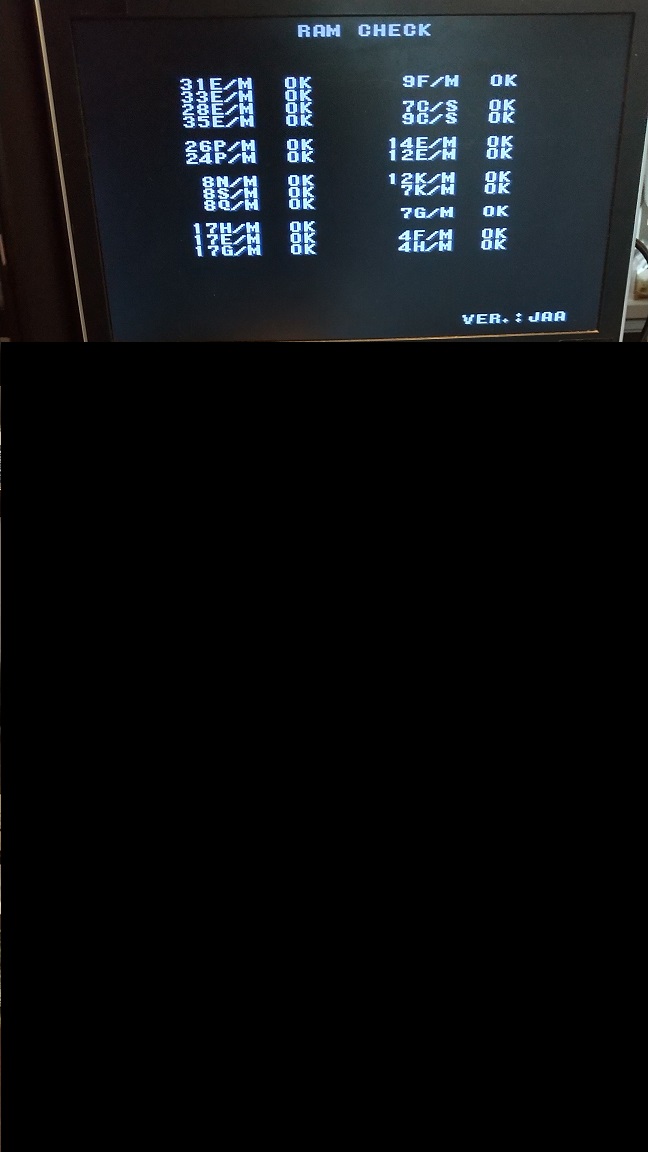

I have since connected 2 different sub boards to the motherboard and tired to boot a game but no matter whichever board I use, the system does a continuous boot loop. EEprom Initialize works fine, all roms come up as "OK" but nothing will start up, just keeps resetting.
Anyone else experience anything like this before?

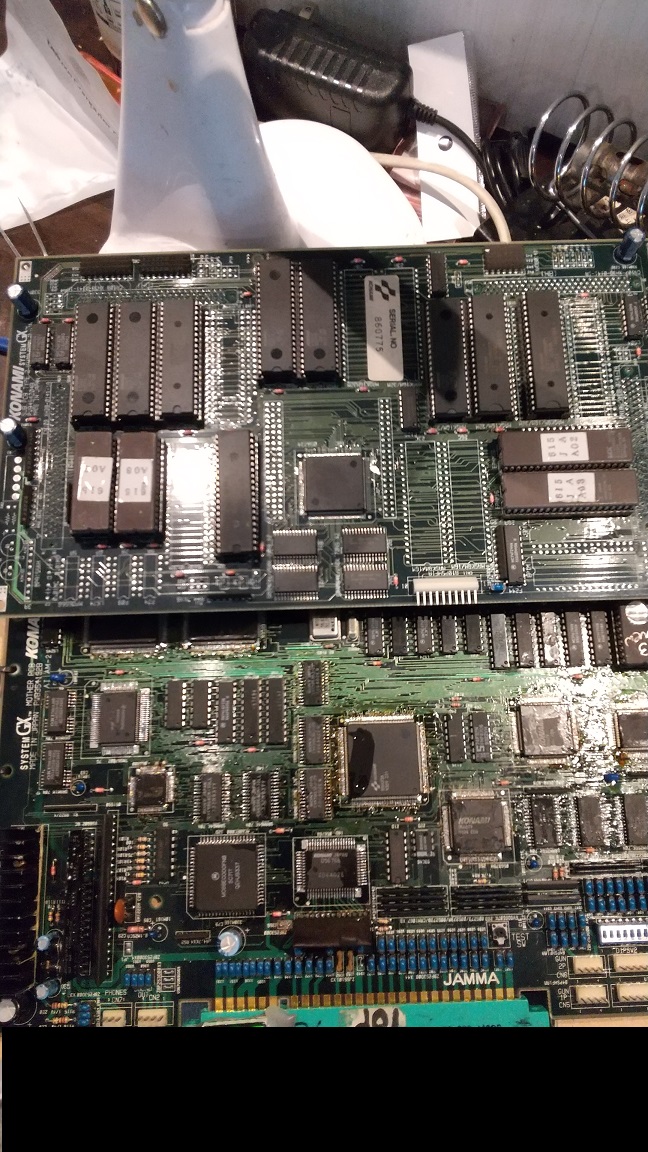

I have tried reburning a different 34K bios , going over the pins on the konami custom qfp, trying to reflow the ram chips. visually inspected all pins on both boards and looked for trace damage but all is fine, checked for 5v on the board and still the same. Really not sure what else could cause it not to fire up.
Both Sub boards are also working fine on a different GX motherboard.
