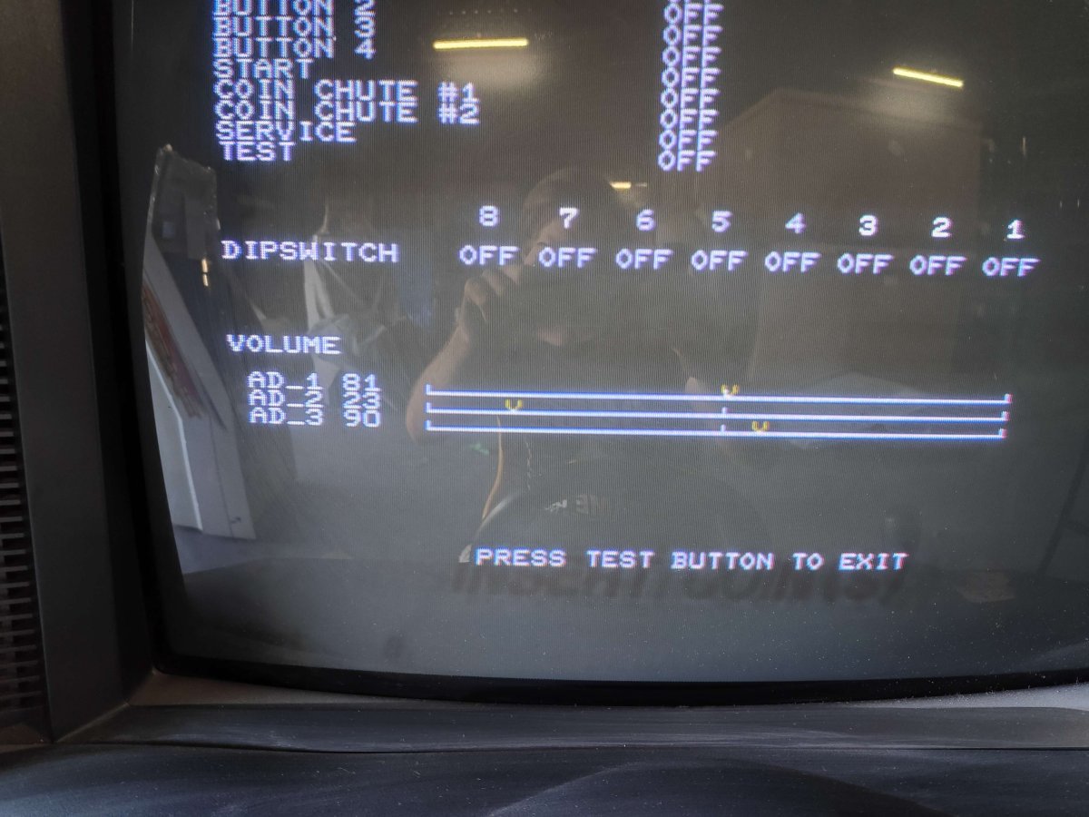

- Adjust the brake pedal gear. The brake currently doesn't go to the optimal maximum range. How does one adjust the gear on this pedal assembly? I'm very new to owning actual arcade cabinets but I did hear the pedals are not too difficult to open in these driving cabs. They are going from about 2EH when released and when fully stepped on they're going to around the 9xH range like in the photo attached. It needs to be around B0-C0, at least for Scud Race from my experience.
You pull off the pot, then rotate until you have the correct range. Make sure the gear tracks correctly before you tighten everything down.
I don't need to fully remove the pedals to do this, right? Both sides had the brakes adjusted like that so I'm sure it's something the operator did.
You can just remove the lid. However, it's pretty awkward adjusting the pots when the pedal set is bolted down. Removing the pedal set is like 5 minutes. It's four bolts and a wiring harness.
