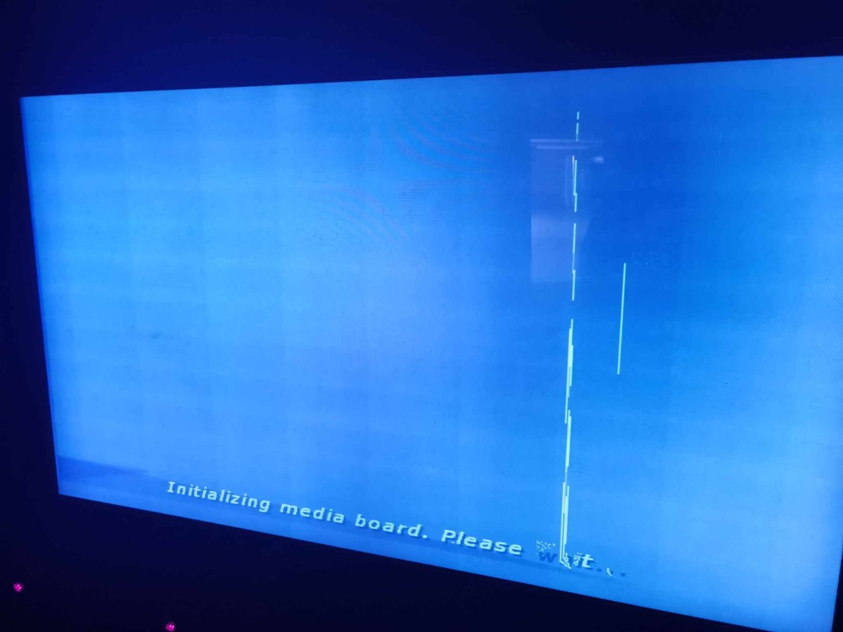

Step 5. Power on and profit. In my case I was greeted by an error 52 message. The ram in this media board has went bad since I last messed with it. You should get error 31 this game is not acceptable for the main board or error 24 no gdrom found ,depending on your jumper configuration.I played around in the test menu and ran all tests I could. Everything works and tested good except for the ram. So this will indeed be a type 3 when I get some new ram sticks for it.
