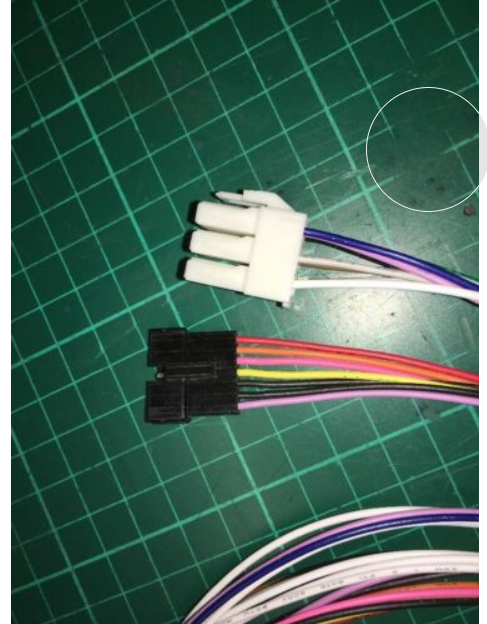

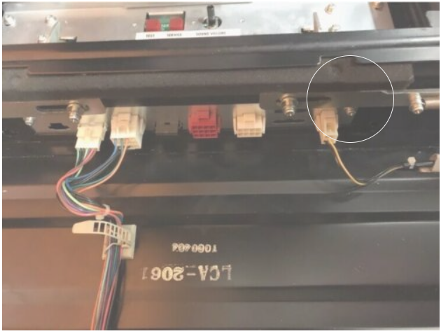

Does anyone know the size or part number for the control connections inside a Sega Lindbergh cabinet? I am looking into making my own harness for different controllers. They are bigger connectors than what are in the Blast City
The connector I am trying to find are the 3x4 12 positions ones used for buttons on the Lindbergh. They are bigger the the TE AMP universal power connectors that are used in the blast city. I googled everywhere and I am having a hard time finding them. I am hopping someone here will know where to find them. Lemony vengeance I know you make harnesses do you know these connectors?

Looks exactly the same as a Noir connector.
As mentioned, the 12 way connector is a YLP-12V
The connector that has the JLF and START button (for the noir anyway) is as follows:
