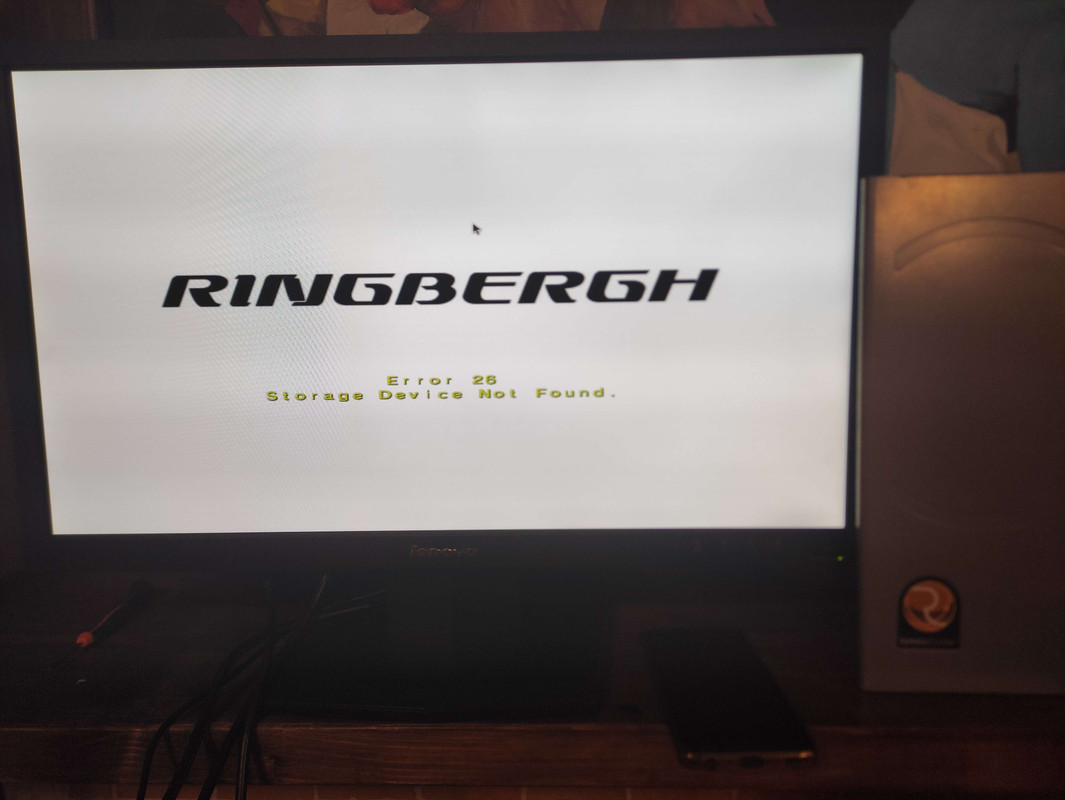

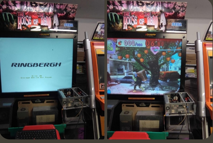

Ringbergh? Wait Sega used RingEdge hardware with a special OS to allow the RingEdge to run Lindbergh games?
If so that's definitely something that needs to be preserved.
I think you don't really have understand that Ringbergh logo is my production and not Sega original one.
