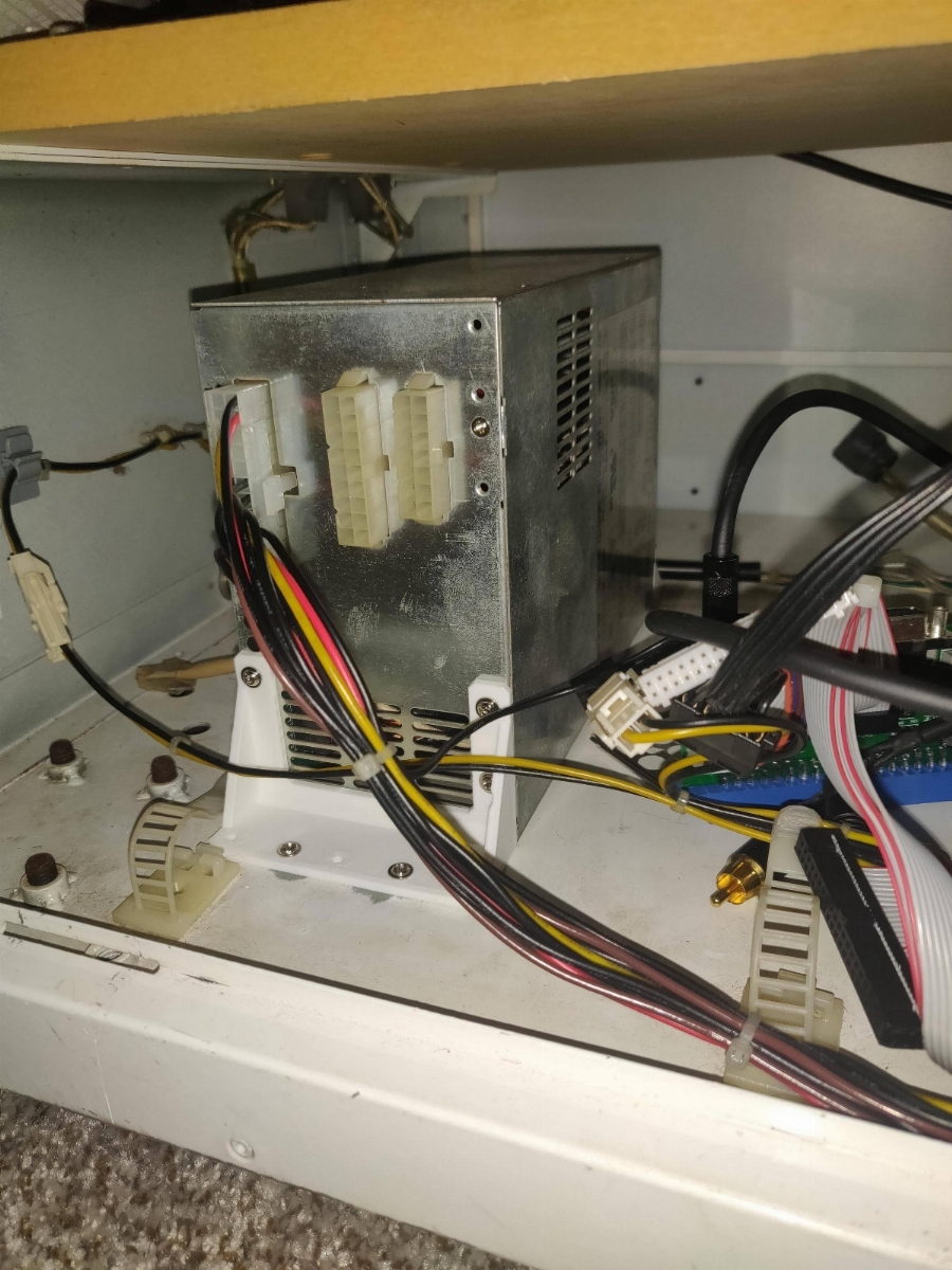

I designed this about 6 months ago, and totally forgot to ever post it anywhere. I didn't want to deal with the stock Wei-Ya JVS PSU for my Vewlix Diamond, so I designed a set of 3D printed mounting brackets to make it easy to mount the Sega Lindbergh PSU in a Vewlix. It's pretty straightforward to print, no supports needed, and I recommend printing it with enough walls to make the vertical parts solid rather than hollow with infill.
I've posted it here on Thingiverse.
