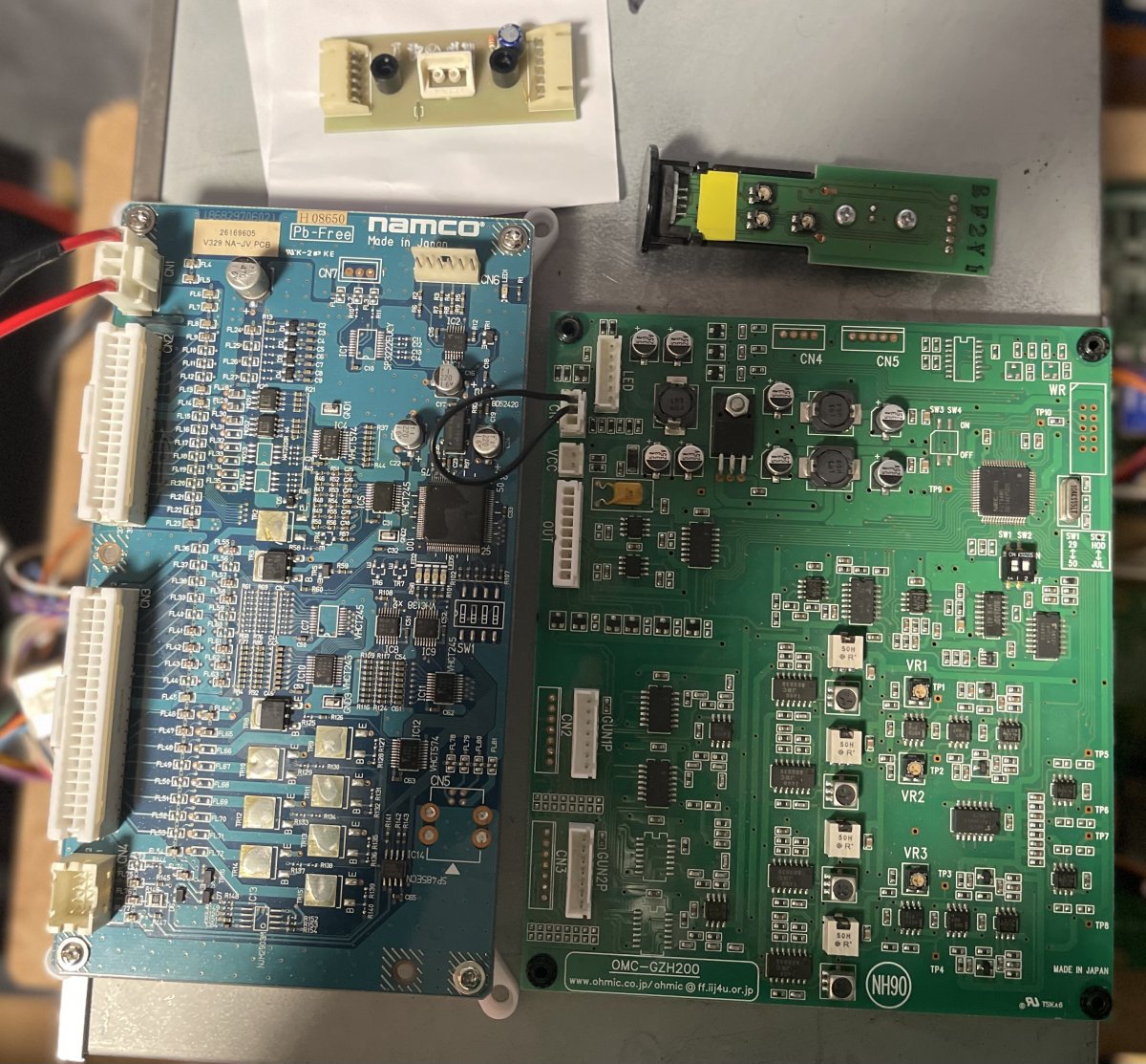

The game uses the “exact” same OMZ IR and sensor setup as Time Crisis 4. Some Sega games also use a similar setup but aren’t compatible. The FCA2 pcb works for both Cobra and Time Crisis 4, but TC4’s V329 NA-JV pcb should also work. The V185/291 pcb will not work as its only meant to fully function with Time Crisis 2 and Time Crisis 3. As for alternatives to the gun sensors and IR leds, there aren’t any unfortunately as they used a special gun sensor and wavelength specific IR leds. You will also need the OMC-GZH200 CPU gun sense pcb to power the IR leds ,the gun sensor, and interfaces with the I/O pcb (X and Y axis). For cobra, the game uses cards and card readers and without the card, the game won’t let you access some levels or would just end up crashing when you finish the last level before requiring the “memory card”. I’m still hip for some patch to bypass this issue. That should be pretty much it. It may seem complicated but I believe in you!

The thing that may be a bit concerning is that the device seems to be used for Sega systems. I’m not sure if Namco systems would work or register properly without modifying the original code.
which of the two is better is more stable for you ?
I would still go for a real set, but for now, I’d say test both the Gun2Naomi and OPENJVS. I don’t think that Gun4IR or Sinden will work unless they get implemented to OPENJVS. I’m still trying to extract some information from my I/O boards so OPENJVS will work with 99.9% accuracy. I’ll keep everyone updated with that.
